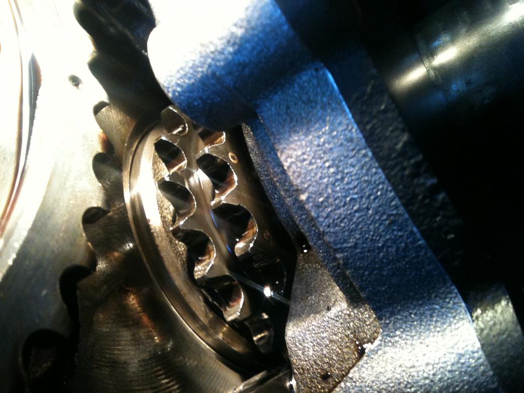

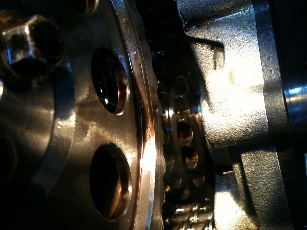

Lets get a dot 2 dot cam timing pic while your swapping cams..?? Or even a pic of before you take it apart..?

I'm going to get a few pics of the dot to dot, and the timing chain. when I find the prob I will let y'all know no worries there.

started the cam swap about an hour ago, just waiting on the crank pulley puller then ill have some pics of the dot to dot and all that.

heres a few pics of the dot to dot, looked perfect to me. all the rocker arms were tight and moved properly.
