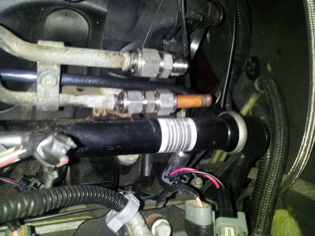

Heres what I did to my truck
But now that atomic makes a regualtor bypass that would work much cleaner, or do what did and get a 04 and up no return fuel rail. I also ran a walbro 400 pump and it fit in the bucket no problem. I did however make my own hotwire kit, I ran a 14 gauge power wire back to the tank and put it though a bulkhead fitting in the top of the sending unit along with a new ground too. Make sure you get a quality regualtor though, I got a professional products one the first time and I could not get it to stop leaking, I think the threads were cut wrong. Zero problems with the aeromotive
