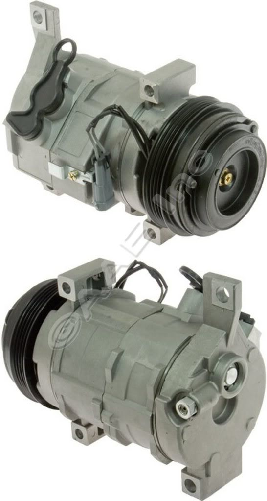

Anyway there is a snap ring holding a silver/aluminum plug in the back of the compressor. It looks like a pop off valve or something like that to me. Anyone know what it is? That is what I thought was relieving pressure from the compressor but that could be wrong and probably is.

IIRC those popoff valves are not serviceable. If it pops due to too much pressure in the system, it releases all refrigerant from your system and you need a new compressor.
Good to know. Then I guess I can rule that out.

The bottom pic shows the relief I was talking about. You can see it is held in there with a snap ring. Thanks smokeshow for ruling that out as the culprit.
