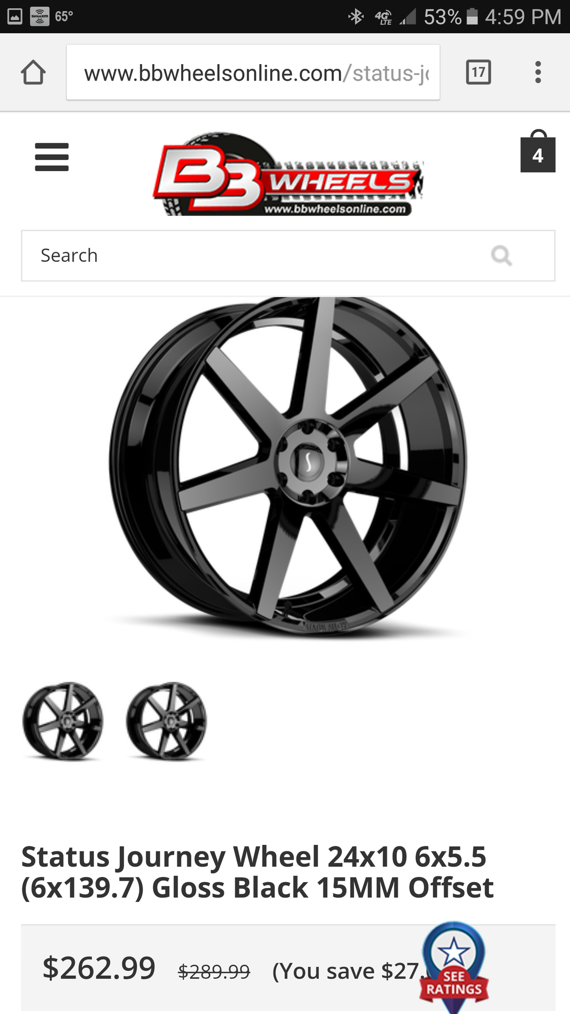

oh wait... i was thinking -25mm. sorry about that. I was going to say tuckign is absolutely out of the question.
with +25 they will be close... I dont think they will tuck. I would expect them to be very flush with the fenders. It it was a +25 and 9" wide they may tuck.
Ok so i need a +30 to be able to clear the fenders then.. i really like the status journey but they come in a +15 and a +25 so idk im runnijg a 9.5 +13 right now with a 305/40 22 and theyre flush

Theyre gonna cut me a +30 offset from a blank so theyll fit

They fit... but they certainly stick out pretty far.
Let's see pics when you have it together.
24x10 status journey milled to a +30 offset with 295/30's
