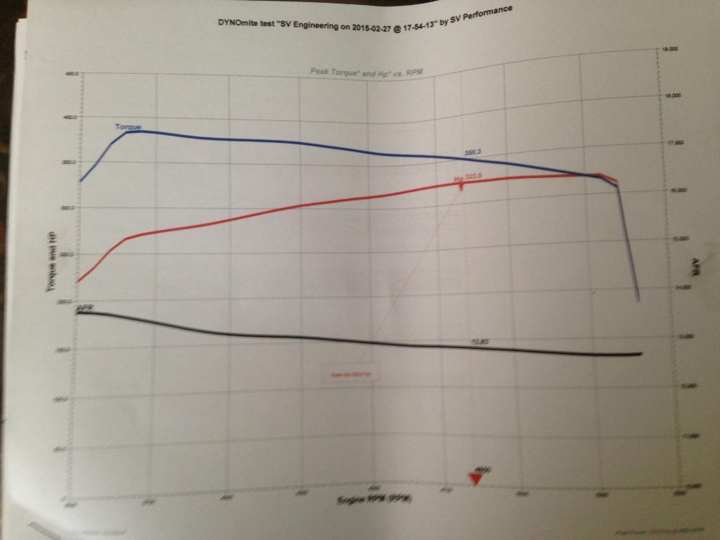

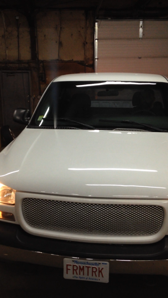

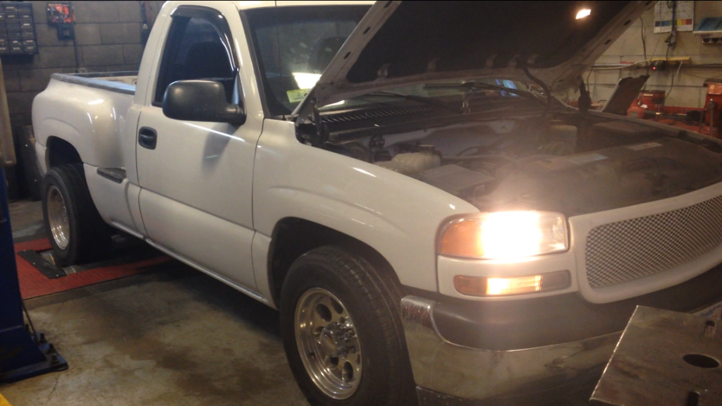

Finally dyno tuned the truck today, down the street from me, by sv engineering. They did a great job squeezing out every last pony. I'm going to head back in the next week or two to dyno and setup the nitrous. I just made n/a runs today. Best run made 323rwhp / 385rwtq on my setup. I was very happy with the tune and numbers.

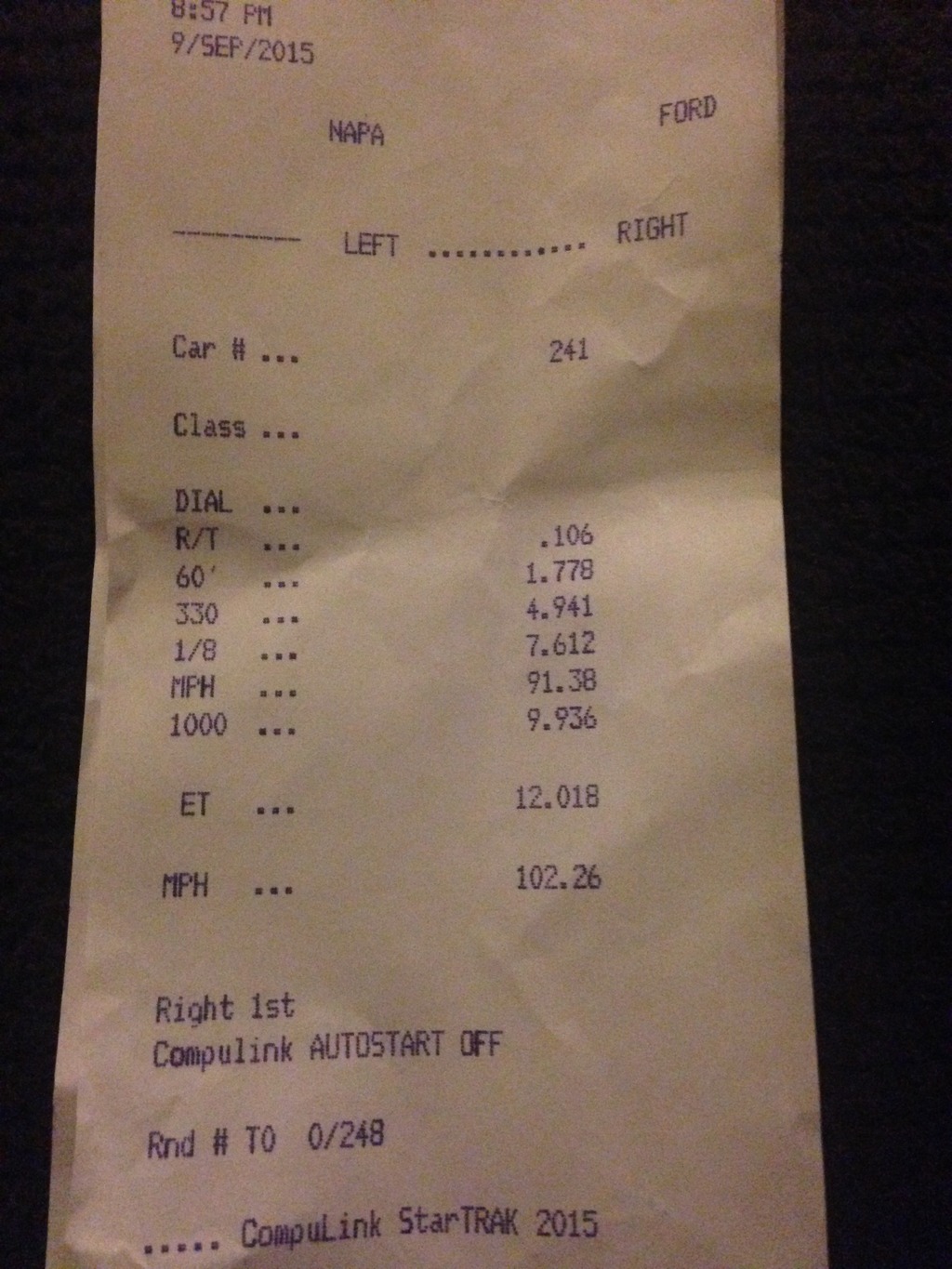

Finally took the truck to the drags today and tested out the nitrous and new rear end. I made a bunch of runs. It was 90*'s and humid today, so im hoping i can crack 11's next trip to NE Dragway. Heres a link to my best run and the time slip:

12.0 @ 102? Great ET, but what gives with the MPH? It's only picking up 11 MPH from the 1/8 to the stripe. I'd figure it would at least pick up 20 in the last 660'.
Not really sure, my first time dragging a vehicle this fast and non-aerodynamic. It's certainly fun though.
