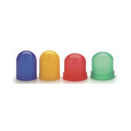

Keep in mind the balast in the led's flicker and burn out quicker than a regular bulb. Everyone loves the LED's in my truck but I'm getting tired of pulling the dash everytime one of them goes so I'm gonna try these rubber covers from Autometer. I used the red for my Nitrous gauge in my car and it looks really good. I put two on to get a deeper color. You can never be too safe...
