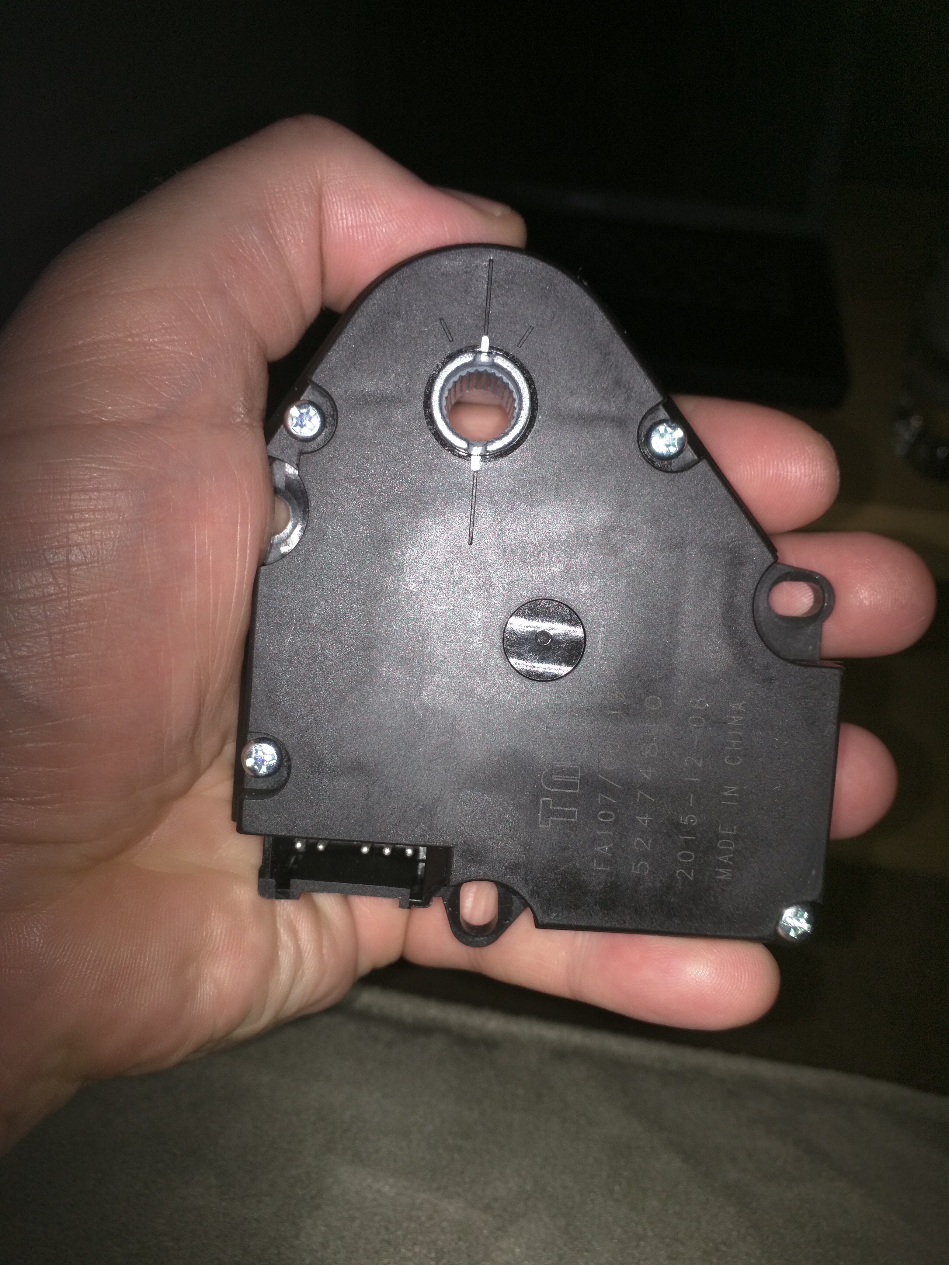

Just showed up in time for bed.

Door moves freely.
Actuator in. Can hear door moving.
Still blowing hot!

I put my finger on the actuator and felt it rotating, but it did not move much.
