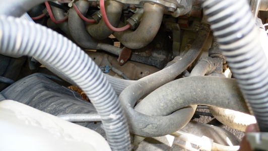

WOW it works it WORKS i tell ya.. i never use the heater so i just did a quick loop from water pump out to water pump in...went out for a drive in this over 100 weather and its way colder..last night i had it on no1 truck feels alot faster too i think i got at least 100HP more
heres a pic to give ya an idea what to do
