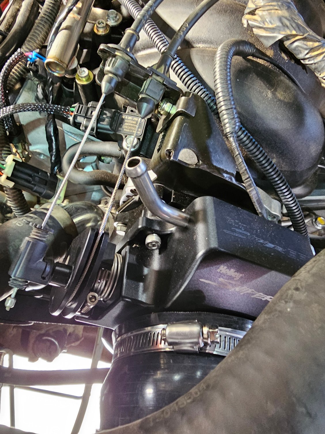

What attaches to this port on the throttle body? I assume it's a vacuum source? According to the instructions with the engine I've attached everything that's supposed to be attached and obviously the ls3 throttle body did not have this port.
That nipple should have a hose that goes to the passenger side valve cover, unless the LS3 has a different setup? 🤔

It runs and idles. Still stock tune but it sounds pretty good! I capped that port. The intake noise this thing makes is insane. Probably because it's essentially an air filter attached to the throttle body? Thanks for all the help guys!!
