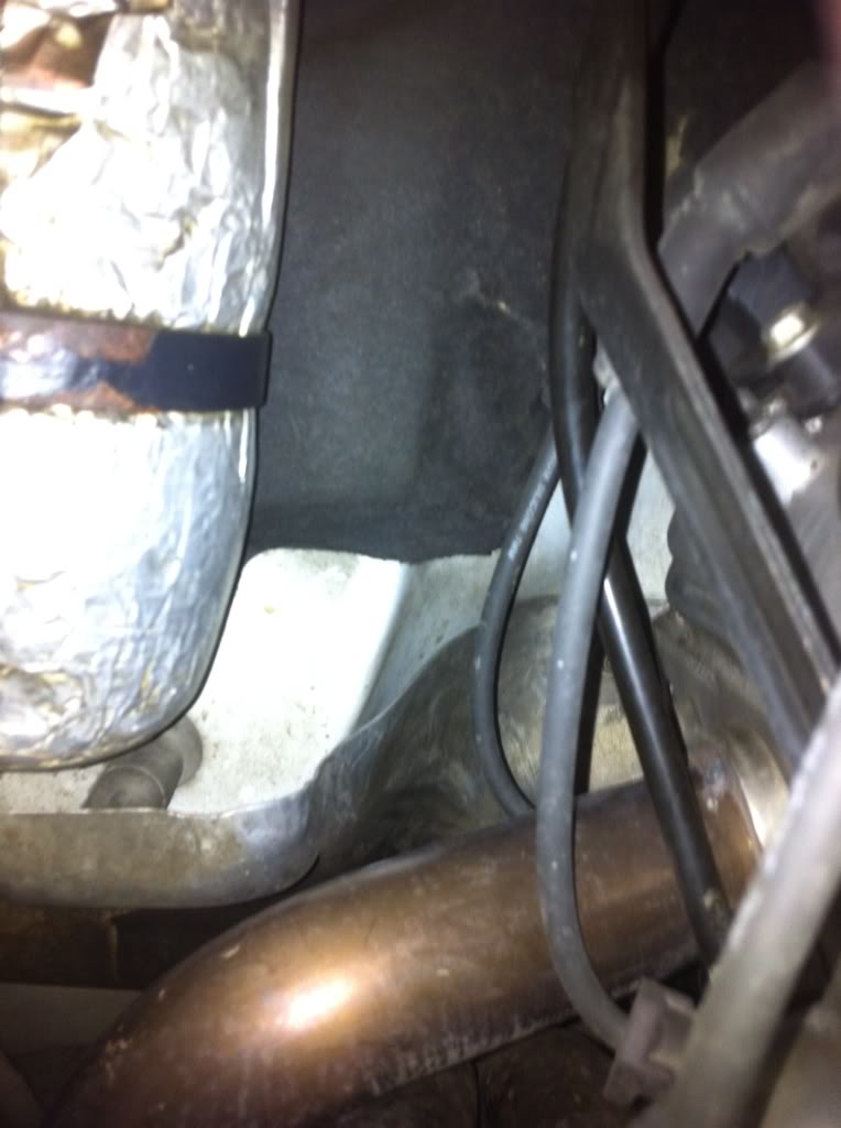

Thanks for posting the pic, but apparently my Tahoe is slightly different. I did a bunch of googling and saw several references about the drain being behind and below the accumulator tucked partway behind a heat shield. I think I finally found mine (see pic). What I can't figure out is most people say it's a 90 degree elbow tube, but mine looks like a plug. When I reach in there and feel with my fingers, it feels like a plug too. I'm trying to remove the heat shield to get better access, but I am having a hard time reaching a couple of the nuts for the shield. This is a pain in the hinny. Any ideas what to do?

Well, I decided to try and pop the plug out with a screwdriver. It didn't seem to budge, so I finally poked through it with a screwdriver and now I have a steady stream of water draining out. I've only had the truck a couple of months, I wonder why someone plugged the drain?

The elbow melted from heat. Be sure to yank it off completely and go order a new elbow at a dealer. The elbow must be in place or it will flood the cab because the road draft going into the pipe while driving will keep water from draining.

I was finally able to remove most of the rubber plug off the drain tube. While I destroyed it in the process, I put the pieces together and examining it. Sure looks like a plug and not a 90 degree tube. I really don't think the elbow melted off what I had on my Tahoe. I plan on ordering a new one. In the meantime, I'll see how it works with it completely off.
