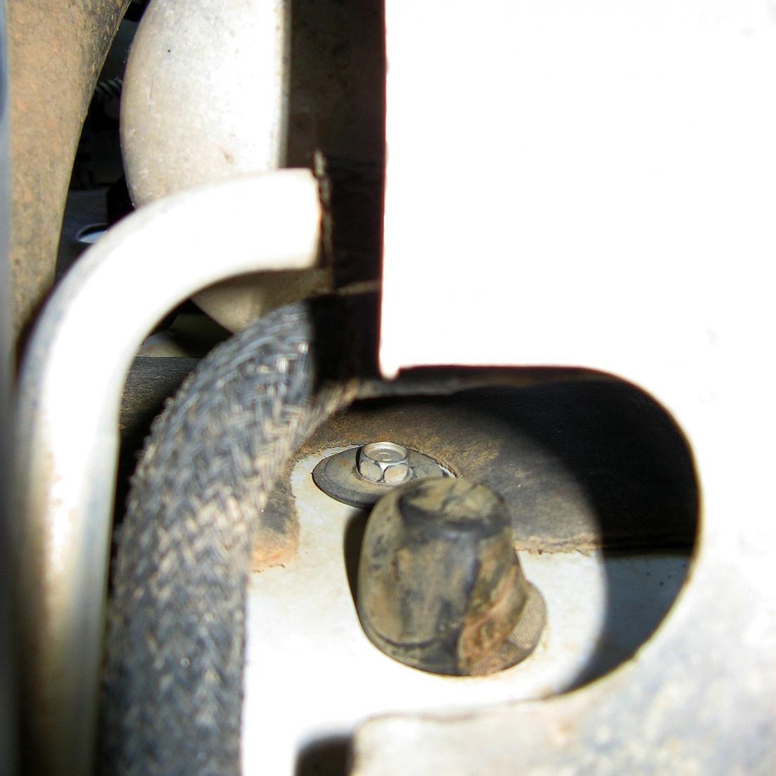

batboy May 28, 2012 10:42 AM
1 Attachment(s)
Thanks for posting the pic, but apparently my Tahoe is slightly different. I did a bunch of googling and saw several references about the drain being behind and below the accumulator tucked partway behind a heat shield. I think I finally found mine (see pic). What I can't figure out is most people say it's a 90 degree elbow tube, but mine looks like a plug. When I reach in there and feel with my fingers, it feels like a plug too. I'm trying to remove the heat shield to get better access, but I am having a hard time reaching a couple of the nuts for the shield. This is a pain in the hinny. Any ideas what to do?

batboy May 28, 2012 11:20 AM
Well, I decided to try and pop the plug out with a screwdriver. It didn't seem to budge, so I finally poked through it with a screwdriver and now I have a steady stream of water draining out. I've only had the truck a couple of months, I wonder why someone plugged the drain?
01WS6/tamu May 28, 2012 02:10 PM
The elbow melted from heat. Be sure to yank it off completely and go order a new elbow at a dealer. The elbow must be in place or it will flood the cab because the road draft going into the pipe while driving will keep water from draining.

batboy May 29, 2012 07:44 PM
I was finally able to remove most of the rubber plug off the drain tube. While I destroyed it in the process, I put the pieces together and examining it. Sure looks like a plug and not a 90 degree tube. I really don't think the elbow melted off what I had on my Tahoe. I plan on ordering a new one. In the meantime, I'll see how it works with it completely off.
