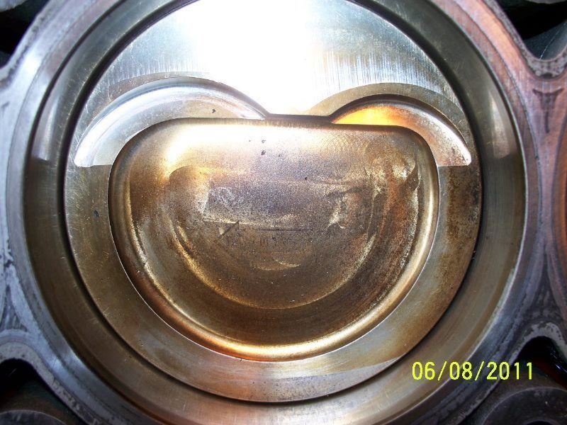

E85 does keep an engine clean. I attached a photo of my 6,000 mile piston out of my 402. When it was run on 93 octane there was a layer of soot on it. The spark plugs are equally clean.

Running 93 and meth my tailgate was full of soot. With E85 my tailpipes don't even get sooty.
