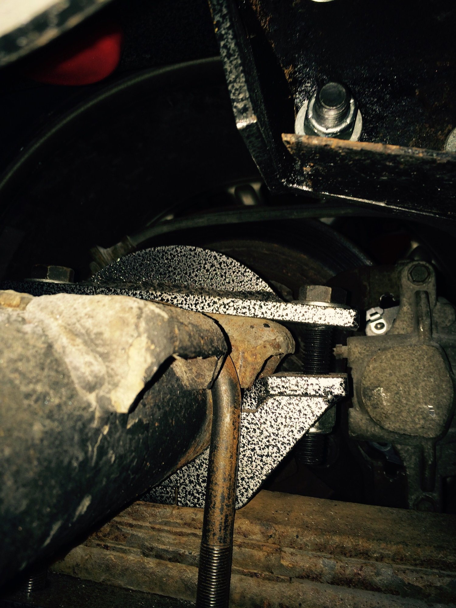

Take some pictures from underneath and post them here.
DJM is known to be poor quality on some parts

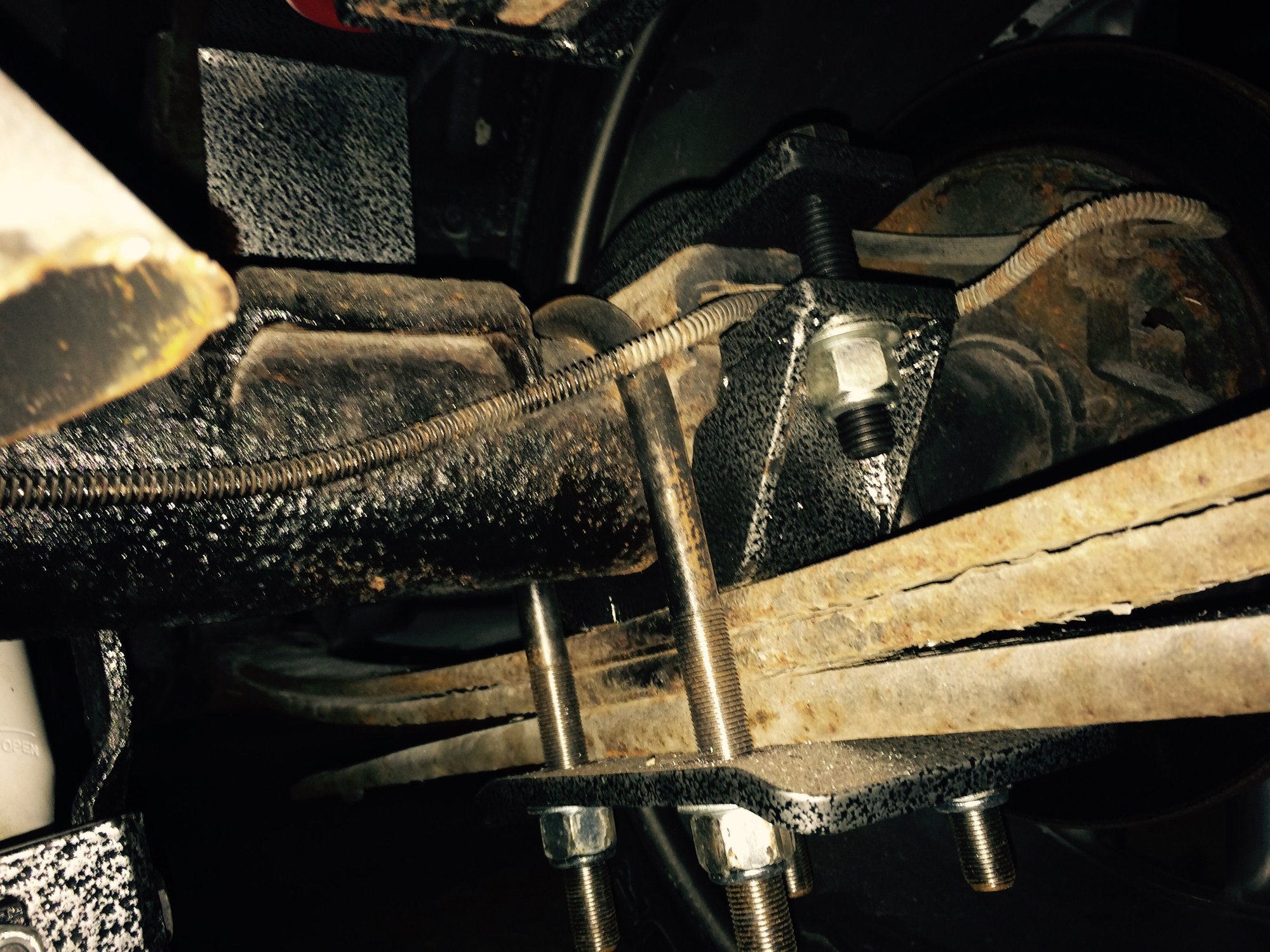

These are all I have. Truck is tucked away for winter

I don't like the design of that flip at all. Your axle very well could be torquing those plates and bolts.
The Belltech design is much better IMO

Yeah they designed it so can adjust your pinion without using shims. Maybe they're not torqued enough or evenly? In one of the pics you can tell the bolt is bending the bracket
