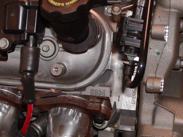

Originally Posted by gtyler04
Still unable to find that code. There isnt a sticker in the glove compartment. So I am not sure what to do. I cant really see any numbers either.
You have the build sheet printed above. What code can't you find? The number 317 that is on the corner of the cylinder head? It's pretty easily visible just below the valve cover on the front corner on one head or the other.
I mean look at your rear diff. Is it a semi floater 14 bolt ( 14 bolts in the cover and it's an off kilter circular cover). Why doesn't it have the stickers..... Couldn't tell you. It's 7 years old and however many owners later.
See the big 5364 on the corner of the head in the photo. Yours will say 317 on it.

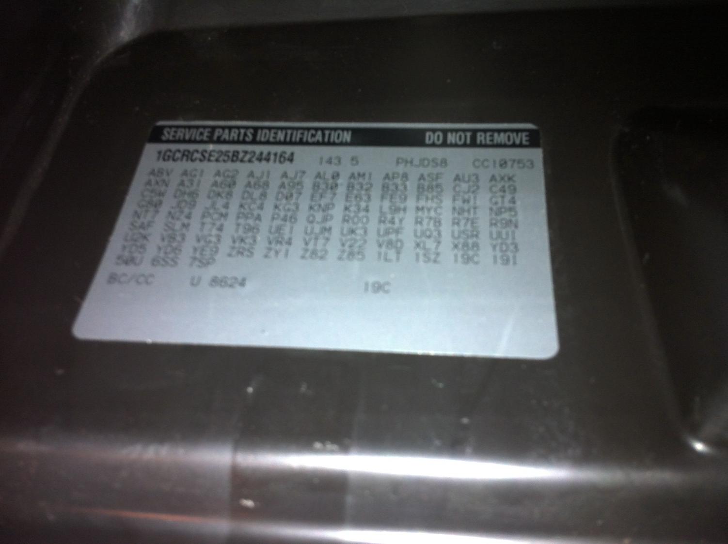

This is what you are looking for on the glove box door. But they are listed in the build sheet from bigred.
Attached Thumbnails Concerned about my SS if its real or not.-build-decal-2011-silverado.jpg
