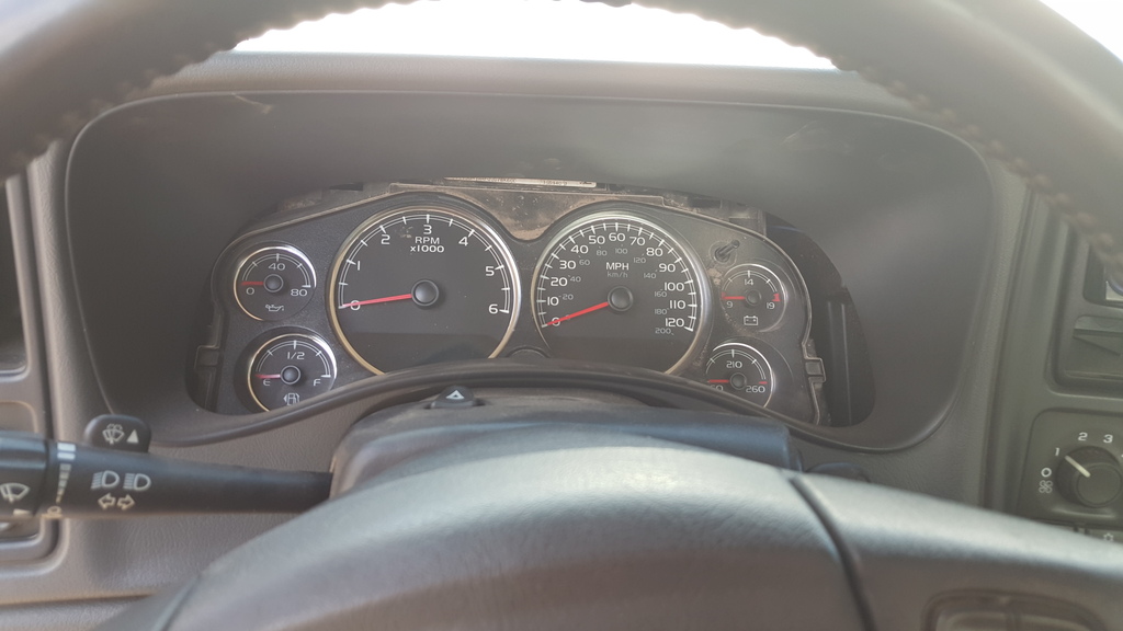

If you worried about the look of the newer cluster in your truck, heres a pic of how it would look i think you could something with closing the openings. And wouldnt you just need to get some wires from pcm to the cluster to make them work and the rest of the interior just control it with the older bcm so the pcm would just need to be tuned to work alone right? Cause i know the older models work that way

Originally Posted by denalircsb
Sounds like a cool project, sure would like to see a 6l80 work in that truck! Been thinking about putting one in my 07 classic but not sure about how to do it yet!
In same boat with my 99 really want a 6l80 or 90 in it but dnt want to go through changing pcm, harness etc.... When the 60 goes out in my 08 i will go 6l80 but thats a lot less involved....
Yea that be way easier. I think i might try that some day if ill do some kind of swap into an nbs truck cause i think it has to work somehow.
