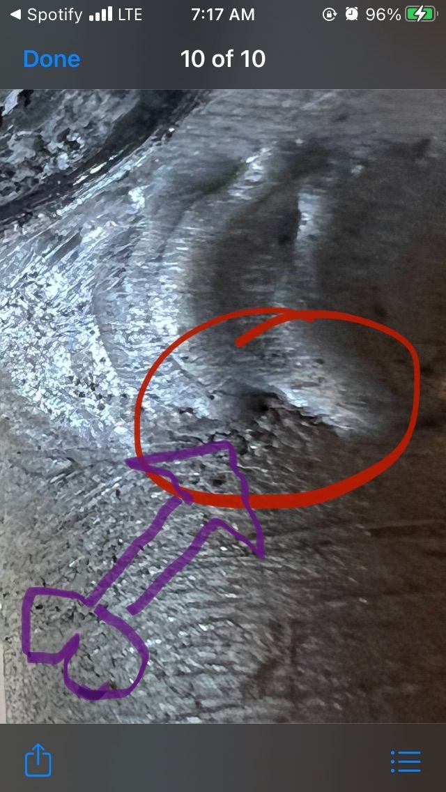

I have had my AC leak from this same spot 4 times now. The first three fixes were replacing the line with an OEM line. Within about 6months they would leak again around the press fit seam where this line meets the connector block. 6 months ago I welded the seam with a very solid bead, today it lost pressure again and is very obviously leaking from that same area. I have not removed the line yet to inspect it up close but I cleaned the area and got my face as close as possible, and I see no hole, or crack where the bubble is appearing from in the video.

Speaking of wieners, shout-out to @arthursc2 for acting as an NDI text line and identifying my crack .
Gonna try to test it better with soapy water tonight and then lay some more dabby dudes on top.

I have no Idea If it's putting extra stress, but that is my theory based on the fact that its leaking at the area that was welded. I am curious if you could drill the pin hole and re weld that area. Maybe it had contamination or porosity in that area down at the base.

It has to be bad welds. Theres no way theres enough force on the connector of the hose to break with a proper weld.
Are you brushing the aluminum and using a lot of acetone before welding? Do you give enough time to clean the aluminum and proper ac balance? Ive welded up ac fittings before and not had them leak but it sucked. Sold my tig rig though
