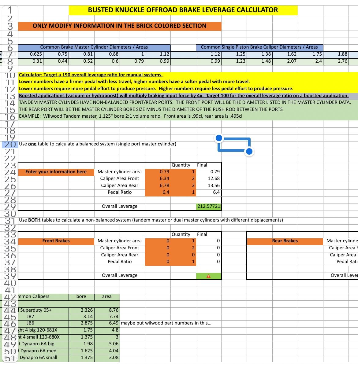

I found a brake calculator of sorts today and started fiddling with it. It’s an excel work sheet from Busted Knuckles Off Roads website. Going by their guidelines I should be aiming for an overall leverage of around 190 for manual brakes.
With all my stuff plugged in I’m at 119 with a stock bore size (1.338”) and a 6.4:1 pedal ratio. Not good.
Now if I drop the bore size down to 1 inch, I get about a 212 overall leverage. Much better and that’s a 78% gain.
Guess I’ll be looking for a smaller master cylinder.

Leverage of 190, 119, and 212. What do those numbers mean? Ratio? Lbs? %?
Old Aug 4, 2023 | 05:46 AM
BuckNasty92's Avatar
10 Second Club
Joined: Jul 2017
Posts: 84
From: KCMO
it doesn’t really give a unit of measurement for it

Here is the brake calculator that I used when I upsized my MC and rear calipers: https://www.tceperformanceproducts.com/bias-calculator/
I agree that it sounds like your Master Cylinder size may be too large diameter.
