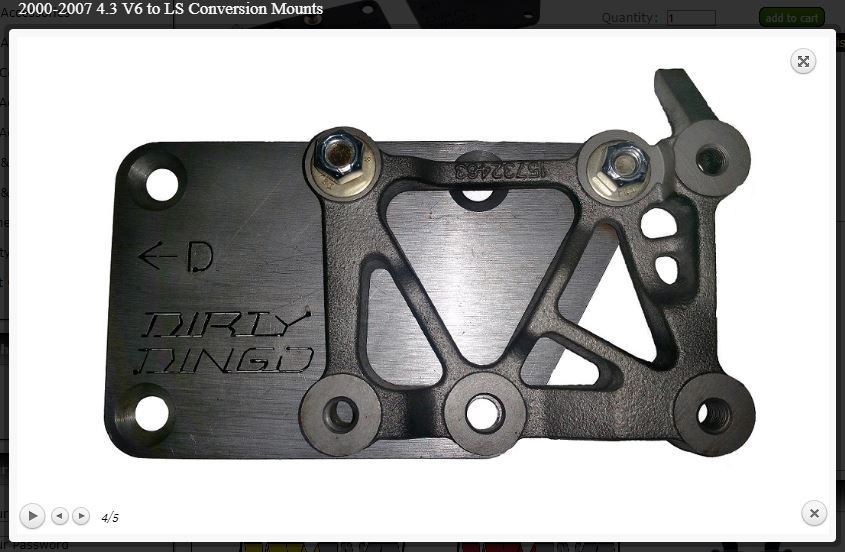

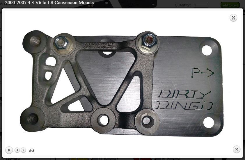

The frames are the same between a V8 and a V6. However there are 2 types of front suspension Coil Spring and Torsion bar. That part is not interchangeable. The Mounts on the frame are different between the V6 and the V8. They have 2 long bolts holding them to the frame. It's been covered several times in the V6 Swap thread. https://www.performancetrucks.net/fo...5/#post5337732
When you have the wrong mount this is what happens.
And these are the plates with the GM brackets from dirty Dingaling...
OP, Using the correct V8 GM Frame mount and The Correct V8 Engine Mounts will solve the issue. The plates clearly push the engine forward.
If not, then Go to a drive shaft shop and ask them if they have a longer Yoke you can purchase or see if they can make you an adjustable drive shaft...
Please let us know what you find.

Hi all. Just wanted to circle back on this to close out the thread. I installed a 2/4 drop with drop shocks and it resolved my driveshaft issue. I used front spindles and rear hangers/shackles. With the truck on the ground the driveshaft is out at most a 1/4 inch. No vibration issues either. I can’t say this is the correct way to fix what happened but I was lucky it all came together.
As for the engine shifting forward I noticed that the metal floor in front of my shifter was bent in due to the shift. It wasn’t much and didn’t match the original gap in the driveshaft. Maybe because there’s more play in that area? I slightly trimmed it with the dremel and I was good to go. The truck rips! Hopefully this will help others out. There seems to be many motor mount combos for this but if you use the dirty dingo plates with oem plates on top of it as the site says be mindful of where the engine will sit. Keep on wrenching all!

as someone who's been on here a long time, i know 1FastBrick knows what he's talking about.
and as someone who's done this exact swap (4.3 with nv3500 to 5.3 with that same nv3500), i'll vouch that the info he provided is correct.
i used the factory v8 engine block mounts that came with the replacement engine, and i bought frame-side engine mount plates from a 4x4 v8 1500 (2wd trucks used different frame plates, as did HD frames [with corresponding 2wd & 4x4 versions]). everything bolted right up to my 4x4 v6 1500 frame & transmission in the same locations that factory v8 5speeds did, meaning the shift tower is still in the center of the floor hole. i'm also still using my factory driveshafts with no extra slip distance in the rear & not too tight on the front. if your suspension mods without matching shocks exacerbated the problem, that's a separate issue.
