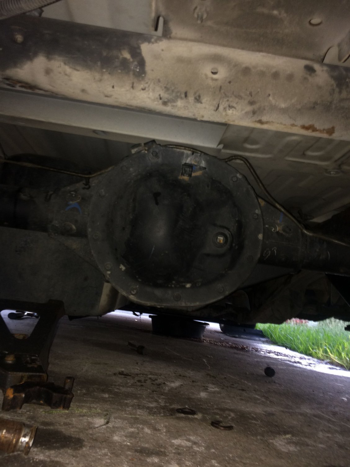

Just in case anybody was wondering it's fits!same length same flip kit same bolt pattern had to delete a couple brackets that were not needed and in the way but pretty strait forward.getting a driveshaft built at driveshafts unlimited in San Antonio I'll let you guys know how it turns out.

Did you use the brakes that came on the newer axle, or the brakes from your original axle?

Same brakes that came with the axle I'm not sure if my old ones would fit looks pretty similar I also had to use my original brake lines

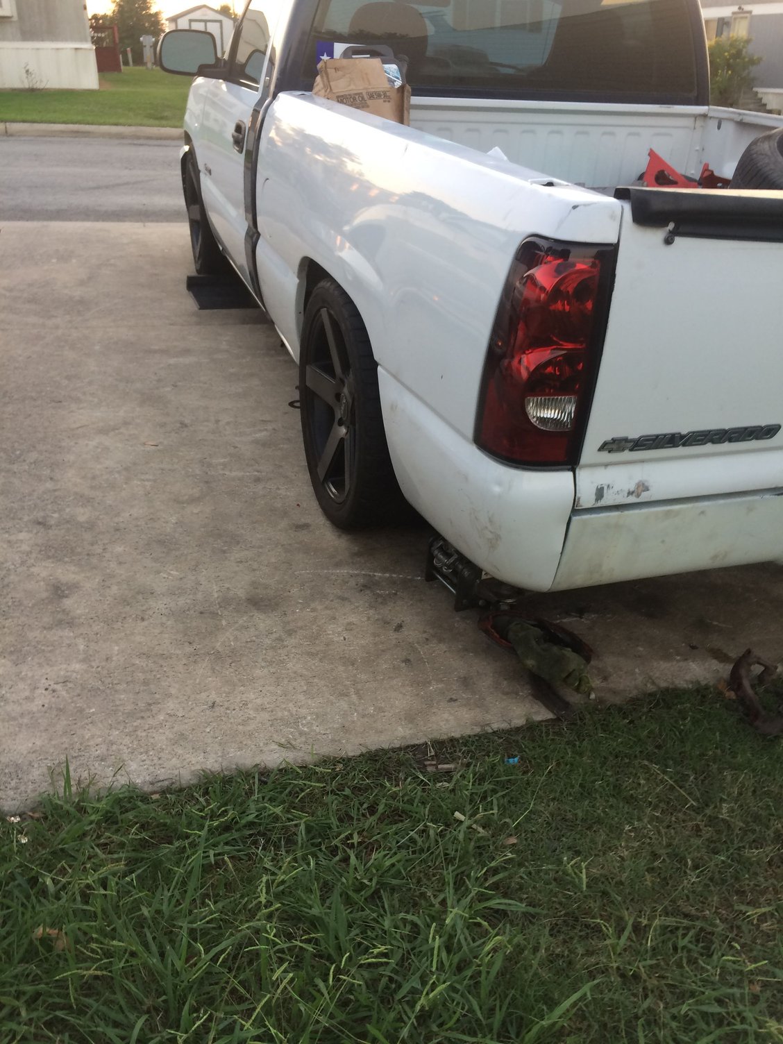

Not to hijack the thread, JW what wheel/tire setup youre running.

Same spring perch locations?

looks like Black Rhino Everest Wheels or Dub Baller Wheels, KMC also makes a similar 5 spoke
