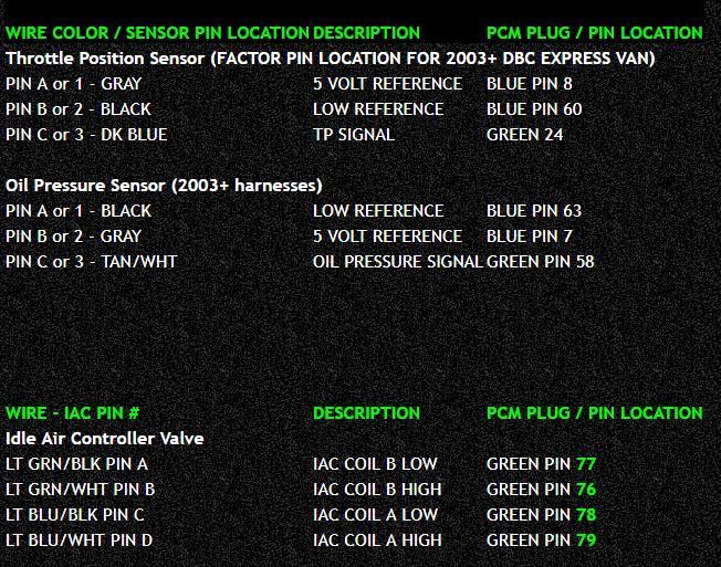

This appears to have some really good information in it.
http://www.lt1swap.com/cable_conversion.htm
DBW to DBC Conversion 03+ Harnesses
Its mostly correct except the vans used it up until around 07 when they swaped to Gen 4 engines and E38 ECU's
but more specifically it tells you how to do it.

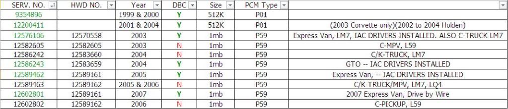

I also saw this posted during my research. Not sure of accuracy of the chart, someone else is the one who posted it.
I would like to do the same to my truck when I switch to a hi-ram

I'm sure its fairly accurate but some of the vans and trucks use the same PCM as the trucks. I don't know the hardware numbers like the PCM Service numbers so I wouldn't know for sure.
My self, I find it is easiest to just pull one from a Van at the local wrecking yard. Then I know for sure it has the drivers. Any 03-07 Express van will work. They are usually about $50 here.
