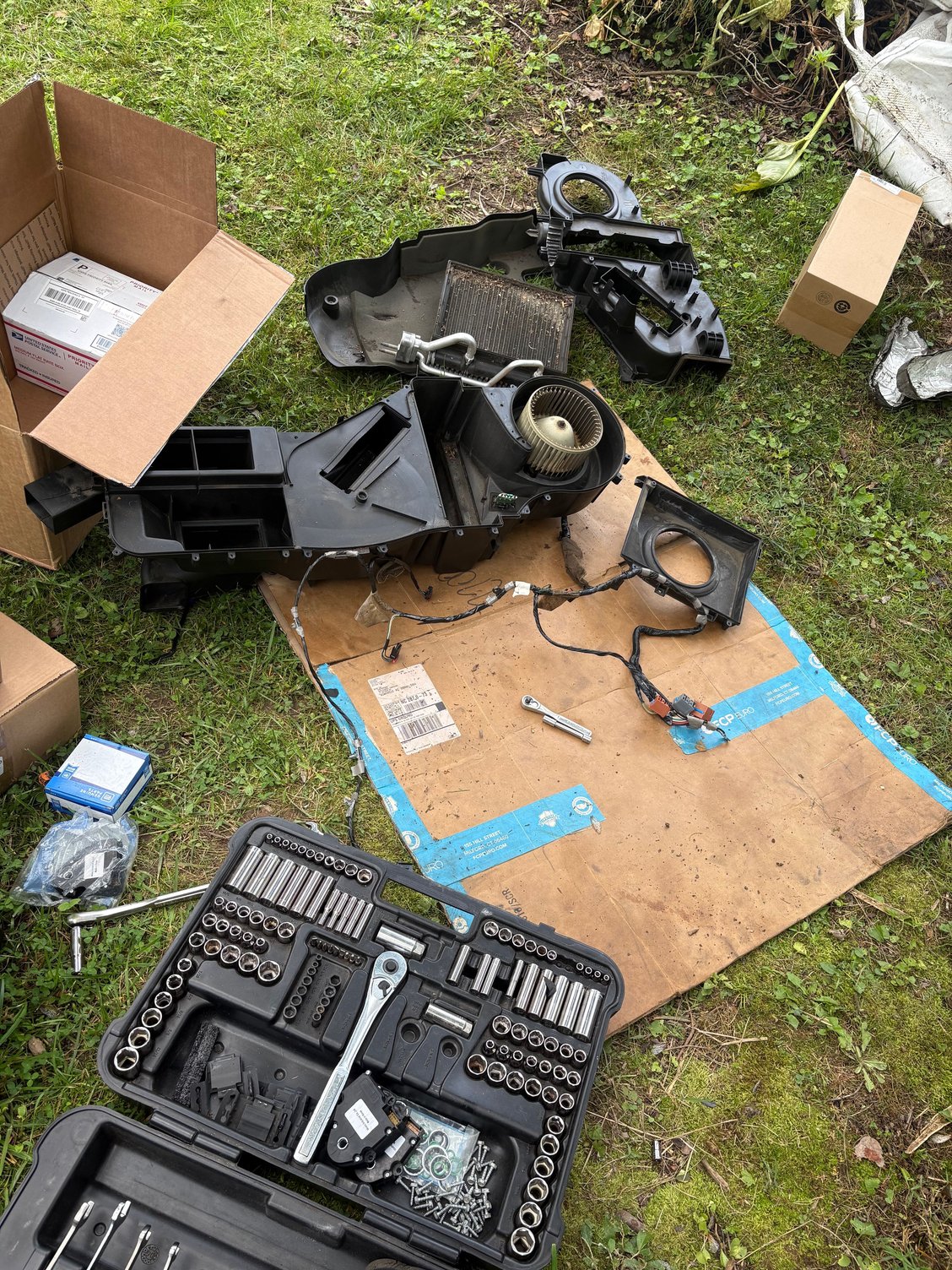

Old Jun 15, 2025 | 04:56 PM
meatwad's Avatar
Fast lane preferred
Joined: Feb 2006
Posts: 664
Likes: 19
From: Western NC
What a pain in the *** that was! All done save for having my local shop recharge the ac system. The dash cover was like saltine crackers it was so brittle. Thankfully it only broke some and more or less is still intact.
Replaced the doors with very nice aluminum pieces from blend door USA. The broken door was obvious once I got it all apart. New actuators all around, but left the fan motor and resistor alone.
the seal kit has been discontinued and I improvised with some closed cell foam I had. So learned there are several bits that need to be transferred over when replacing the evaporator core and receiver/dryer.
The dash was a pain coming off and going on, as was the hvac box itself. It think most of my time went to wrestling those two into position!
Well, it’s done now.
