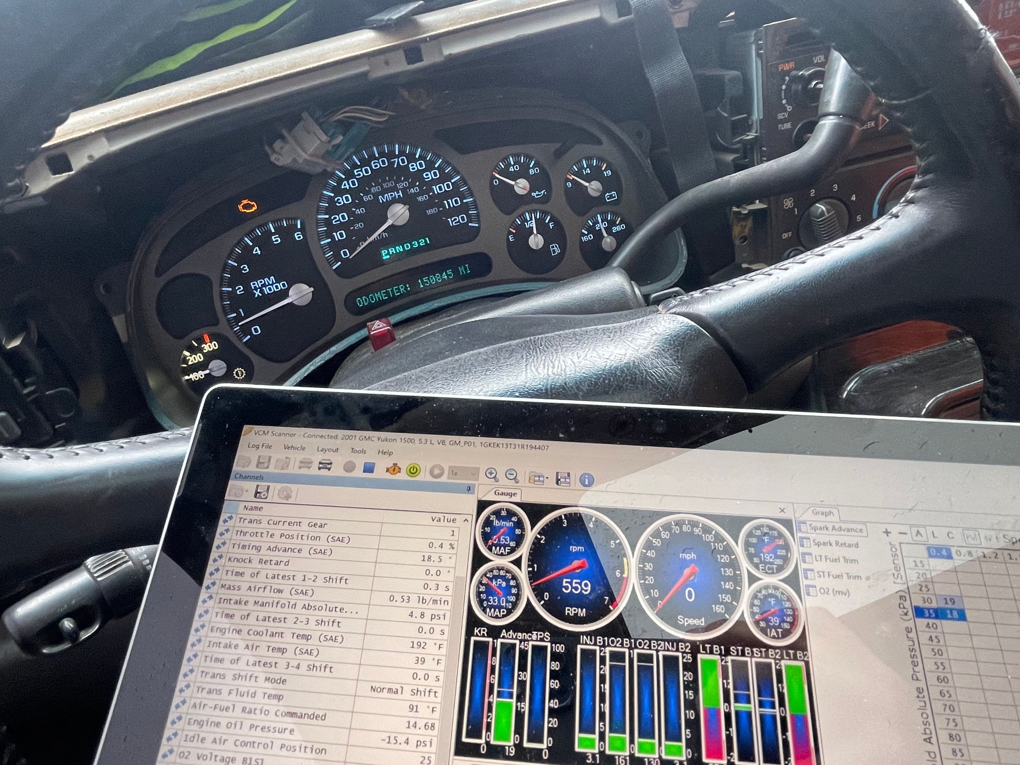

I always wanted to do this conversion and finally got to do it on my buddys truck as a test dummy lol. I got all gauges working beside the battery and oil pressure needles to work… trans temp works but as you can see on hp tuners temps only at 91. I made a plug and play harness all I did was rep-in the wires

@Dolph572 The battery and oil pressure needles don't work because of how the circuit board is built. The way to do it is you have to move some of the traces around. Please figure it out and post a how to so I don't have to pay $900 to get an 03-07 cluster one day thanks
Edit: The stalk works so you can switch to trip mode correecT?
