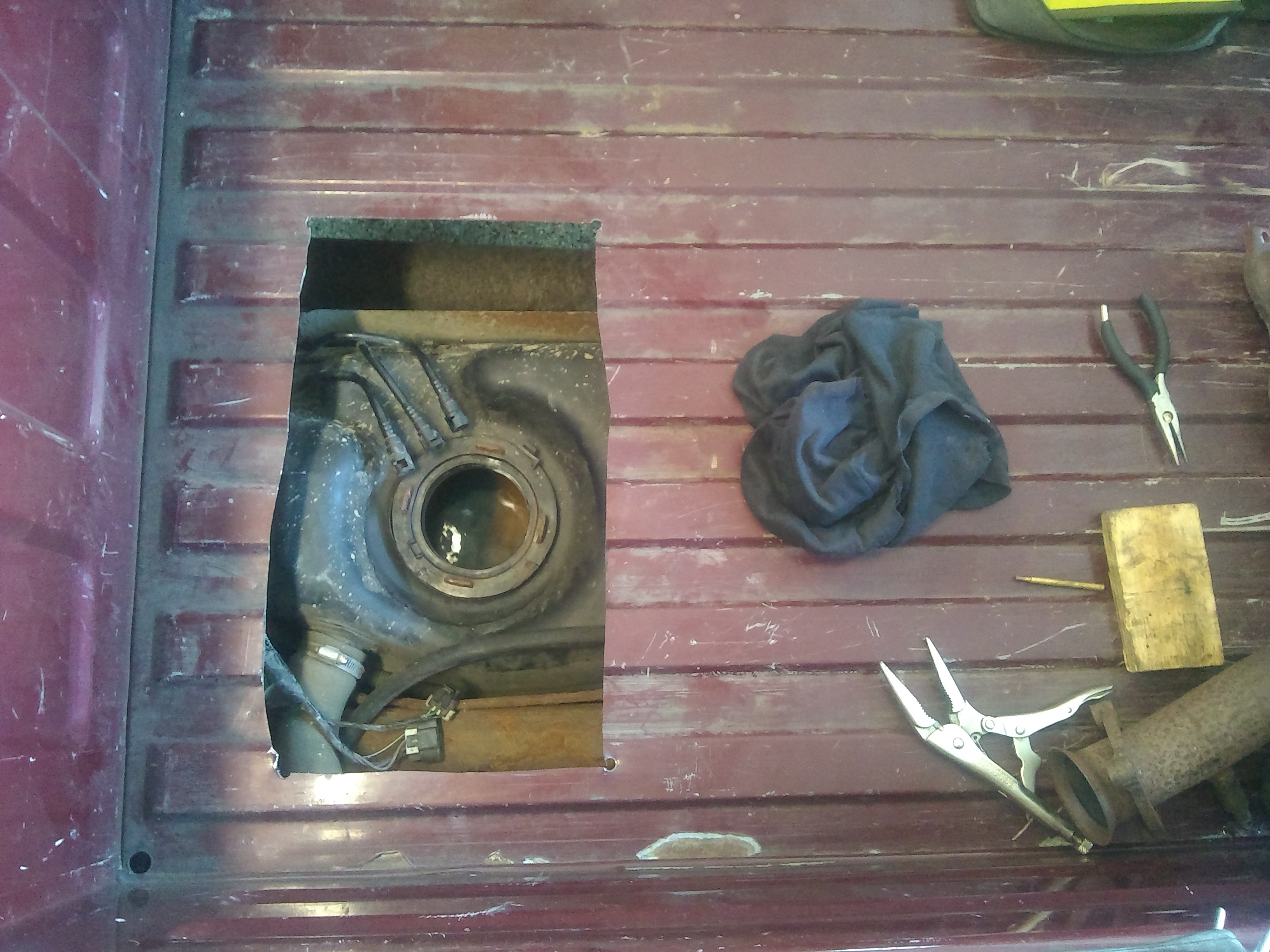

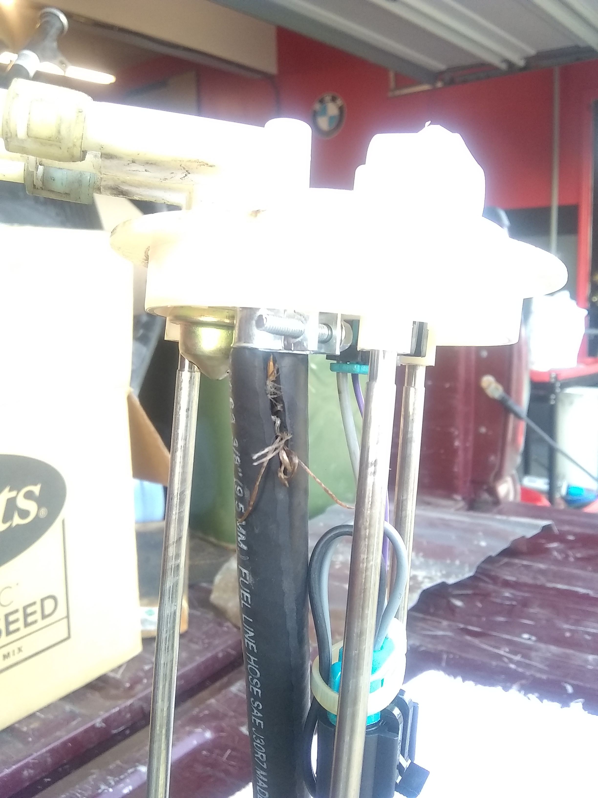

Turns out the hose they ship with that 450 is junk, it's fuel injection hose but NOT rated for submersible.
Step 1: cut shitty hole in shitty truck

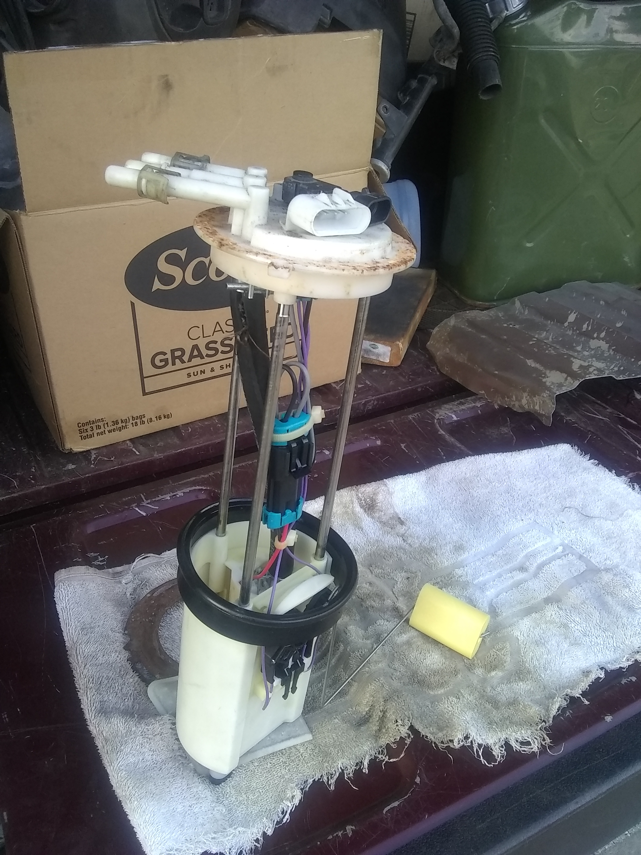

Step 2: remove fuel pump you installed 6 months ago
Step 3: admire failure of incorrectly spec'd hose
