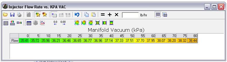

Originally Posted by 00Z71
They start at 35.4lb @ 0 kpa, all the way to 38.4 @ 80 kpa.
At 60 KPA they are 37.95
I am reading this off an 06 flex fuel stock tune read.
You're right
Here's a screenshot of the stock tune from the truck the injectors came out of.
Attached Thumbnails FS: GM Flex Fuel Injectors-ifr.jpg

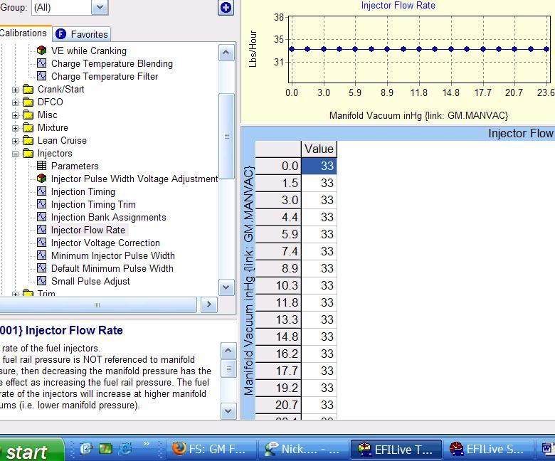

How does one explain this screen shot from a 04 FF tune?
Old Apr 2, 2008 | 12:50 PM
Joined: Nov 2004
Posts: 1,051
From: ODESSA, TX
Wow, I guess that there are two different flex fuel systmes out there.
Is that screen shot from a 4.8 or 5.3?
My response is based on an 06 5.3

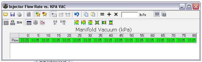

Hey KB, that's weird that it says 33 across the board. For sure, the injectors I have aren't 33, it looks like they're 35.4lbs/hour. This is a screenshot of the stock tune from my truck. It's a '06 5.3 LM7
Attached Thumbnails FS: GM Flex Fuel Injectors-ifr2.jpg

Just for ***** and giggles I pulled up a 04 Tahoe L59 tune and it's the same as what kb has. Here's the SS:
Attached Thumbnails FS: GM Flex Fuel Injectors-ifr3.jpg

I wonder if It has to do with returnless fuel system.

Ya, I don't really know what the heck the deal is, but the couple 04 return FF tunes I have (including the one I put in my dads 72 have 33 in the IFR table, but if that's the table out of the truck they came out of, then that must be what they are

Yeah I guess... this is really confusing haha. I've never seen a IFR table like that until now. I wonder if the same injector p/n flows differently under a different fuel system. It definitely will with changed fuel pressure.
BTW, just checked out ACDelco's site and they use the same flex fuel injector for a broad range of vehicles ( ACDelco 217-1626 ). The injector for the '04 tahoe is the same as the '05 avalanche. I have a feeling that it's the fuel system.

If the IFR table has the same value in the entire table, that means it is a return-style based system.

returnless systems run higher fuel pressure. so the flow rates would be different in the pcm.
