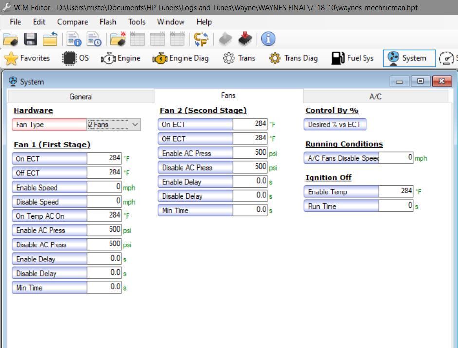

How do I identify. Is there an RPO code? Measurement? How do we confirm.
Is there any programming needed. I have HPTuners.

I think it's 34 " for the radiator and yes you have to turn them on in your ecm

Found the settings.

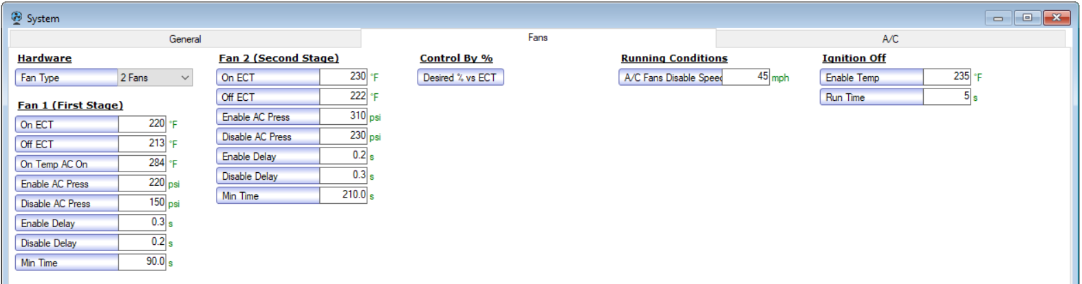

For reference, these are the settings in my 03 Denali taken from an 06 SSS stock tune. (P59 PCM)
