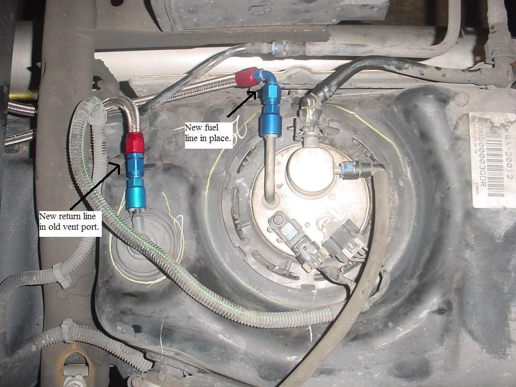

I am installing a turbosmart FPR 1200 which will convert me from a returnless to a return fuel system. My question is can I use the stock gas tank breather port as a return?
Here is a picture I got from god knows where but I think it ended up woring for this guy.......

I'm thinking that heavy stainless braided line is going to flex and snap that very tiny tube on the return port with time and vibration. That would be one nasty fire.

No matter, there is somthing on the other side of that fitting that is too restrictive for a return so I ran the return right into the top of the sending unit....
