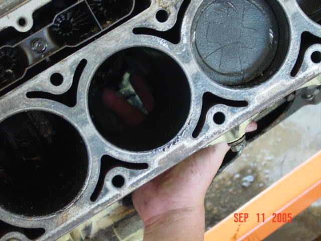

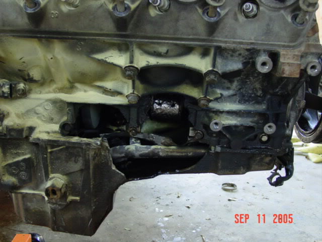

Gonna need to upgrade the rod bolts for sure. Ive seen what CAN happen at about 6400 on the stockers
I know a LOT of people exceed that on a normal basis with the stockers, but mine just decided it had enough I guess.
Im not sure where the rods become the weak point, but I imagine its way over 7K
