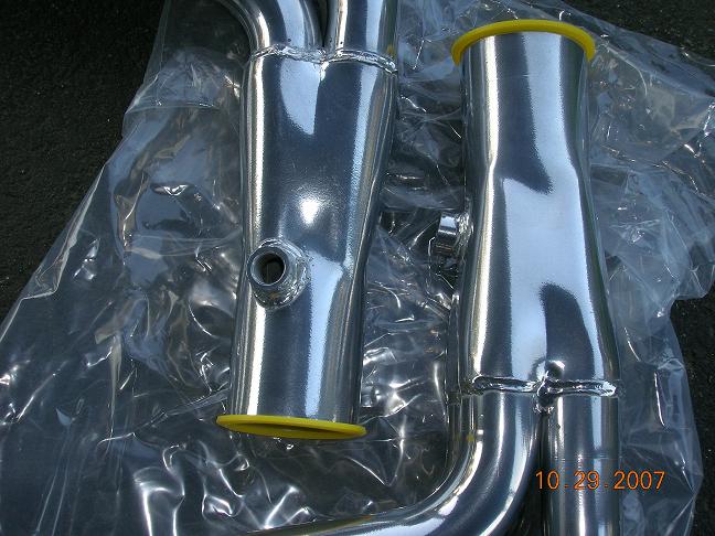

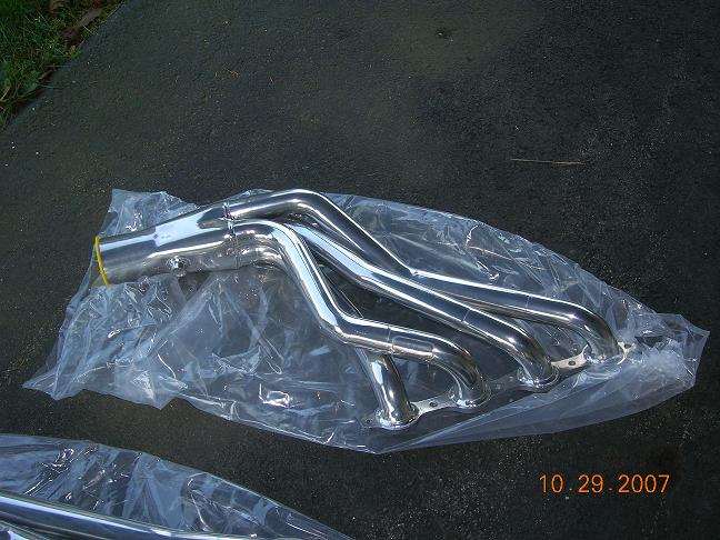

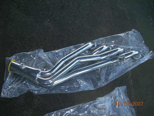

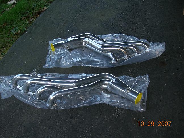

got my headers and the drivers side 02 bung is welded to the top of the collector that can not be right is that how it should come or should i call pacesetter and start pissing and moaning

The bungs can be anywhere in the top half of the collector as long as they are above horizontal so that condensation cannot accumulate on the sensor. Of course they also have to be accessible.

Hey i dont remember mine having any yellow at the collecter?.....Then again i dont remember what I did last week. Dam...But seriously why is it yellow?

Looks like plastic plugs that were probably popped in there for protection??

it's supposed to be at the top. there's plenty of room. you're good.

the yellow looks like a plug, but yeah the bungs are like that on my pacesetters.
