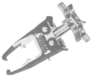

I just did a swap this past weekend with the compressor that they sell at sears, the old style compressor and let me tell you it was a piece of ****. My hand still hurts from turning the thing a million times, please get something besides this one.
Attached Thumbnails Which Valve Spring Compressor?-sjdiscounttools_1937_26112808.jpg
