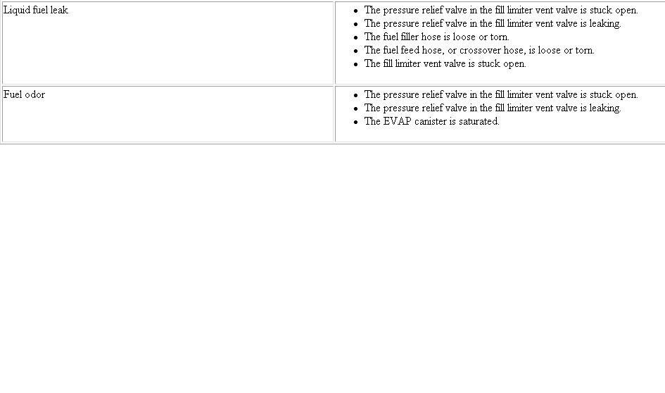

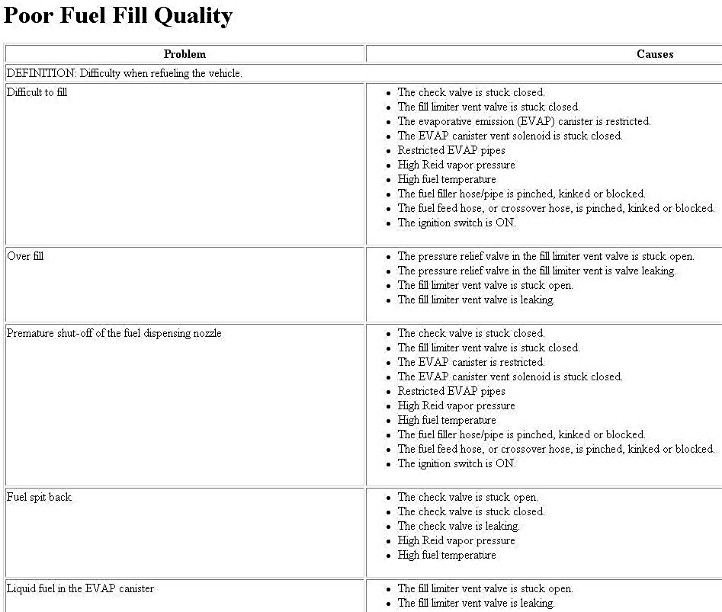

Looks like there are several possibilities:
Attached Thumbnails Truck dosn't like gas anymore..... WTF-fuelfill1.jpg   Truck dosn't like gas anymore..... WTF-fuelfill2.jpg
Nice find.
Premature shut off of the fuel dispensing nozzle:
The check valve is stuck closed----I can push it open with a pen
The fill limiter vent is stuck closed----??
The EVAP canister is restricted----Maybe full of gas as stated above
The EVAP canister vent solenoid is stuck closed---??
Restricted EVAP pipes----??
High Reid vapor pressure----Tank hisses now???
High fuel temperature----Has been way hotter before, and it was cool tonight and it still happened
The fuel filler/pipe is pinched, kinked or blocked----Removed fill neck and tube and all is clear, unkinked and undamaged
The fuel feed hose, or crossover hose, is pinched, kinked or blocked----Think it is the same as above
The ignition switch is on----No, never on
Good info here, where did you get this jem???

That info is from the eSi service manual. Some items refers to dual tank setups(e.g. "crossover"). Some components may be part of the evap module. I would try disconnecting the tank vent line from the evap cannister, etc. as described by budhayes3 to isolate the problem.
