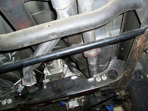

exhaust can hold you back
Ive gained at least 4 tenths in the 1/8th just screwing around
with mine
TOGS TD magnaflow with xpipe and a little 45 after the xmember
lets see .4 x 1.56= .624
I think thats the 1/4 conversion

4 10ths in the [b]1/8th[/]??? From a simple exhaust change up?? That sounds a bit on the wild side unless you had a problem soemwhere. LOL
does dont it
2 from the togs and magnaflow
then 2 more when I just reworked it without cats
Im thinking the cats may have been shot
either way Ill take it
