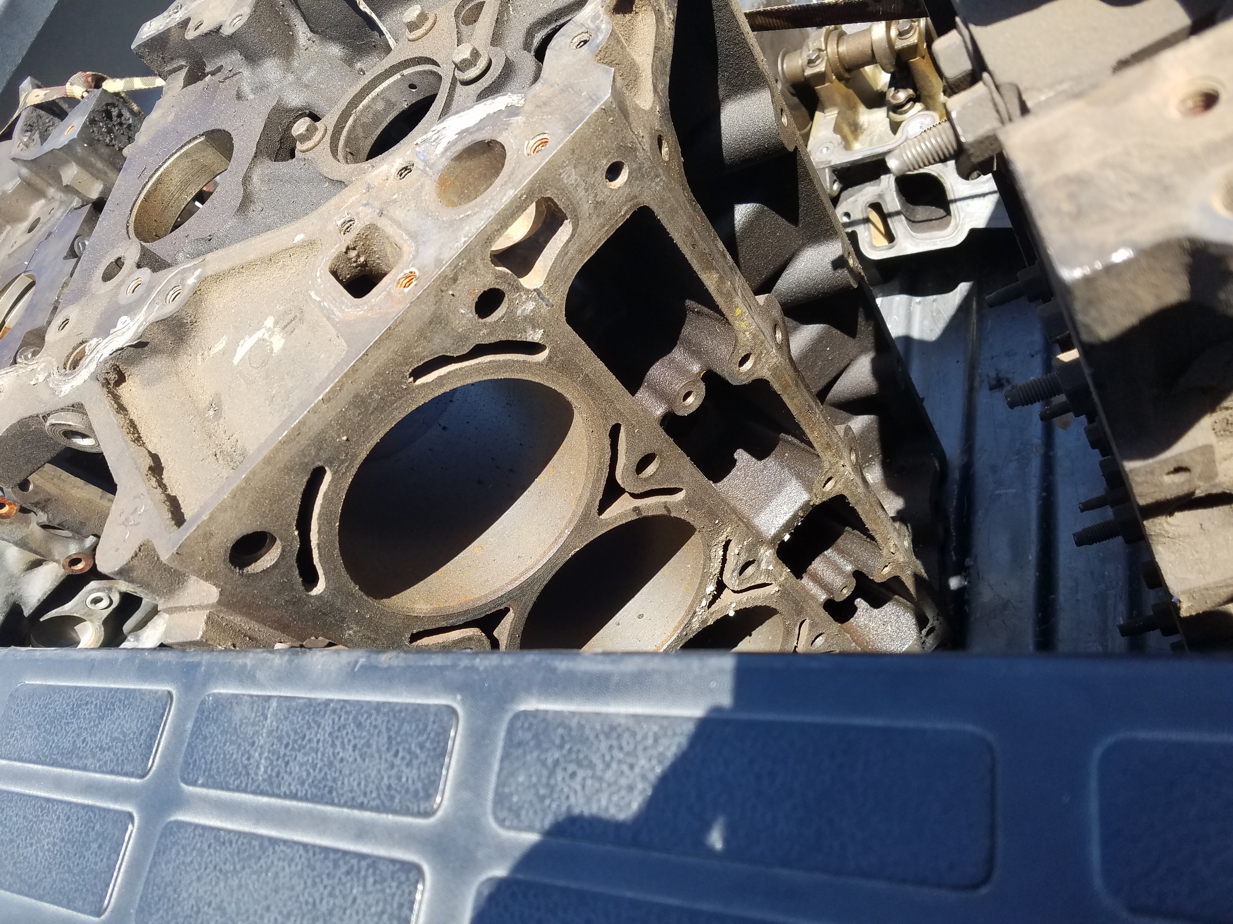

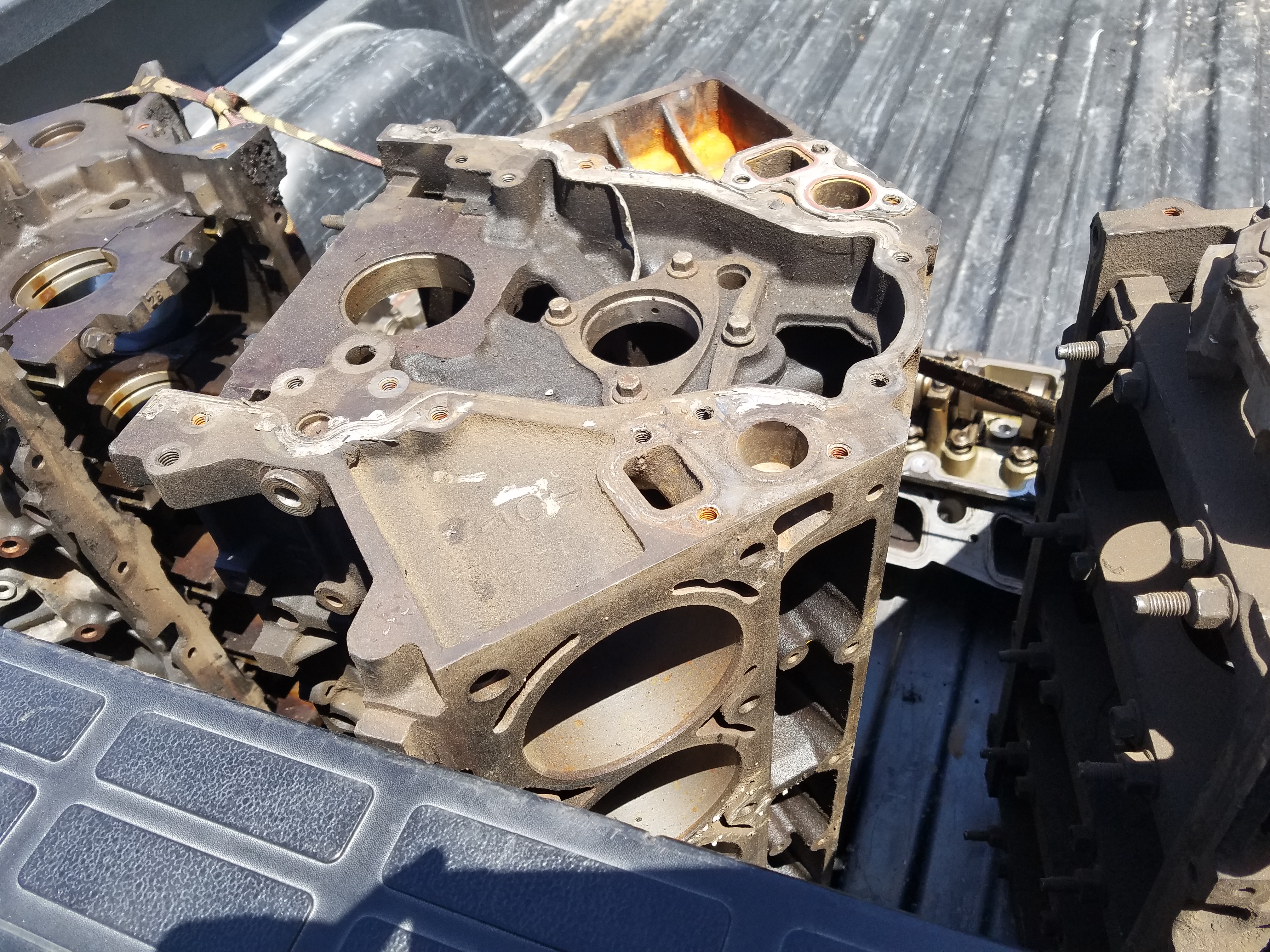

Whats up guys!!
Have awesome news! I ended up picking up a bare 6.0 block gen 3 for 100 bucks!! In AZ now cant find one less than 250. Everyone wants one! Not in bad shape! My brother owns a machine shop so I can get some killer deals by just doing all the labor. Just parts at this point.
So on this 6.0, it would be my first full on build. I know over a 5.3 my current mods done to 5.3 do it to a 6.0 and its 60+ horsepower over it all. But I am not sure on what to start with.
My goals is to be a dependable 400+rwhp na id possible? (Not even thinkable with a 5.3 unless its forced inductions or nitrous.) What kind of bottom end am i looking at? Forged or just good quality parts?
Also seen people doing 408 strokers or a 370. What are everyones experience on these??
Attached Thumbnails It was time to upgrade-20180420_131304.jpg   It was time to upgrade-20180420_131257.jpg   It was time to upgrade-20180420_131310.jpg
