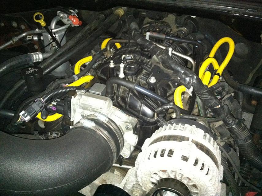

I think I'm having issued with my intake again. I have a really rough start, and when I pull my gas cap off the truck runs rough as well. I no longer run the Evap and all those vodes are turned off in the tune. I was pointed in this direction by a fellow member, and I really need to get this figured out because its a PITA!!! I simply plugged the vacuum line onto the correct spot on the new intake, but I dont know if thats all I need to do...
Can someone else help me out here? Here are some pics of how it currently looks.
