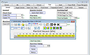

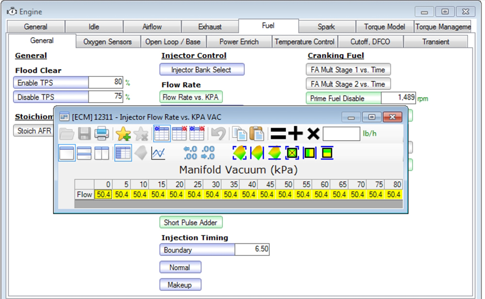

The only difference between the return and the returnless rail that is of concern is in the tune. The old Gen3 with the vacuum referenced regulator on the rail has a static Injector flow rate in the tune. The Gen3 mechanical regulator regulates the fuel with the vacuum signal. The Gen4 (returnless) is regulated through the tunes software and has a progressive fuel rate in the tune table.
This is an example of 50lb/hr flex fuel injectors with a (return) vacuum referenced regulator mounted on the rail. You can see the numbers are static throughout the entire table.

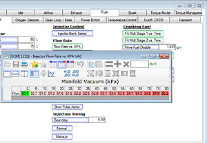

This is the injector flow rate table with the same flex injectors running the Corvette (non vacuum) regulator. You can see how the tune itself manages the flow rate vs the old gen3 vacuum referenced regulator.
