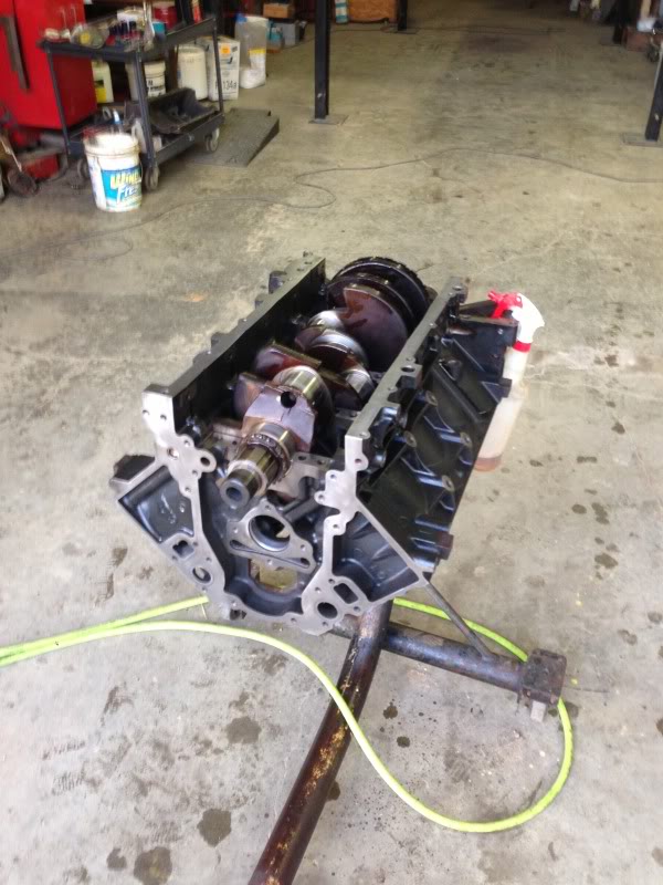

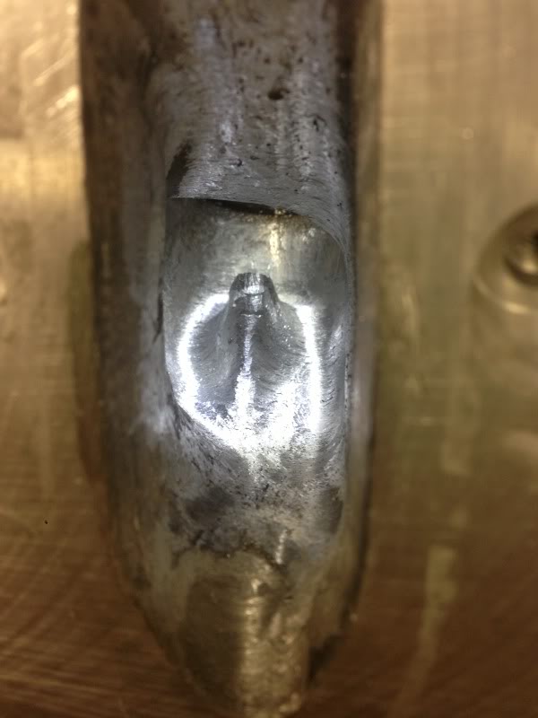

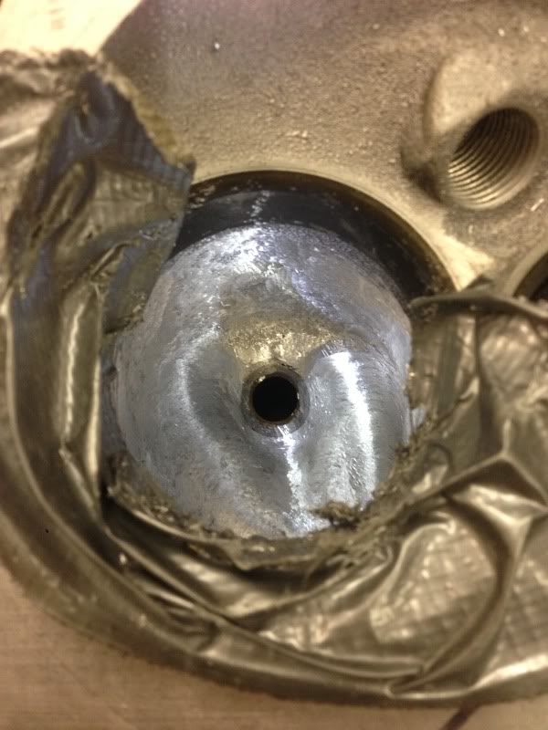

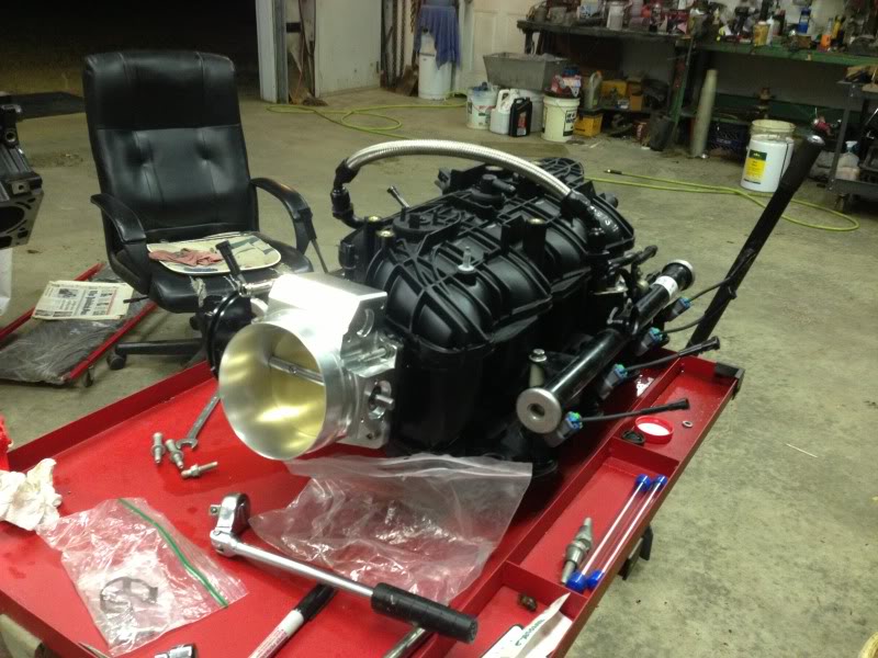

Hey guys just thought I'd start posting pics of everything I started working on. I've had the motor since march and I've been in the process of tearing it down and collecting parts till now. So far I've got the rotating assembly in the block and that's it. I'm waiting on my cam to be ground at the moment and I'm doing a little port work on my heads while I'm waiting on that.

Now the motor

Sounds like a fun build! I was looking at nearly the exact same setup but with a smaller cam since I have an auto and still wanted to tow.

Nice build looks good!

Thanks guys I'm hoping for around 420ish to the wheels. I at least wanna be over 400.
