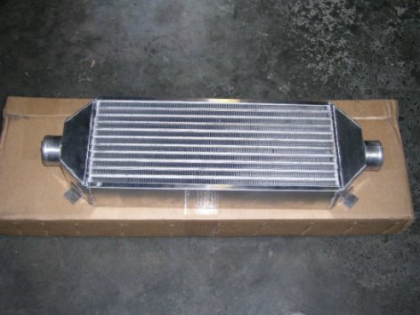

Yesterday I installed a small IC mounted under the passenger door next to the frame. The core measures 24" x 8" x 3.5" with 2.5" inlet/outlet. It was very easy to put on, I just removed a section of pipe and trimmed a fews inches from the other pipes.
My IAT's use to run about 30-40 degrees above outside air and would soar to over 160 on a 1/4 mile pass at just 5lbs. Now with the IC on, in 50 degree air, cruising iat is around 80 degrees and a 1/4 mile pass makes 105-120 degrees.
Today I decided to make a small air scoop out of sheet metal. The opening on the front is about 4". I then bent the front edge down another 1.5" like an air dam on the front of a car. This scoop made a big difference.
Now, IAT's are around 72-80 in 50 degree air and after a 1/4 mile pass even turning the boost up from 5 to 7lbs they only rose to around 90 degrees. After lifting, they quickly returned to 80.
This style of IC is definitly worth the little time and money spent. Although later I plan on moving it to the front in hopes of getting the cruising IAT's lower. Hopefully knock another 10-15 degress off.

Here's a picture of the IC.
