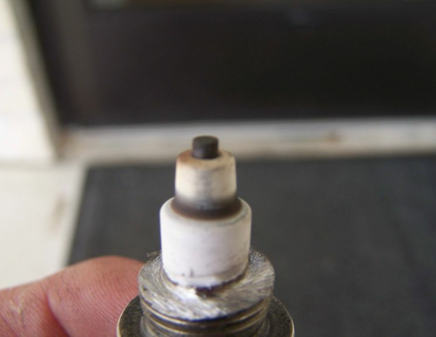

Check this website to understand why your pictures are woefully inadequate, uh6tdrvr. And that website doesn't even get into AFR plug reading diagnosis, where you need a lit magnifying glass to see down to where the insulator meets the inside of the plug body to see how high the carbon ring comes up the insulator. I attached a picture of a plug that a guy cut the threaded portion off to see the carbon ring to show his WOT AFR. It​ is actually on the rich side.
But we know that you are not worried about the mixture in a stock engine. The first link should give you everything you are interested in
