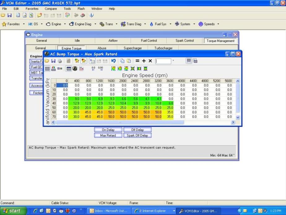

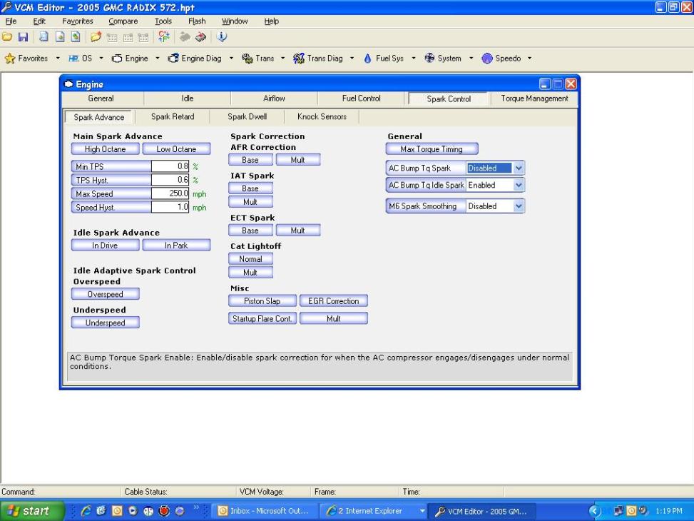

Originally Posted by slow.8
my truck will hiccup ever so slightly when i turn the ac on, even with no belt on the compressor. it feels like the compressor is kicking on and of, which of course it isnt. i dont know if thats something in the tuning or what. its a constant thing until i turn the ac off.
Yes its in the tuning:
There is a ignition timing table that retards the advance by 30* to 40* during A/C compresser comand on and off.
Attached Thumbnails slight hesitation on highway?-ac-spark.jpg   slight hesitation on highway?-ac-bump-timimng-retard.jpg

thanks, i know my comment was off subject but its something id been wondering about.
