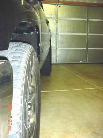

Here's my truck. These stick out 2 inches further than stock. I don't think 1 more would be bad at all.
The back one is exactly flush and level with the rear fender.
The front one sticks out about 1/2" from the fender.

Hmmmm.....That doesn't look bad at all.
Jim get some fender flares and some wider rims with the right offset to run the 14" wide tires.
