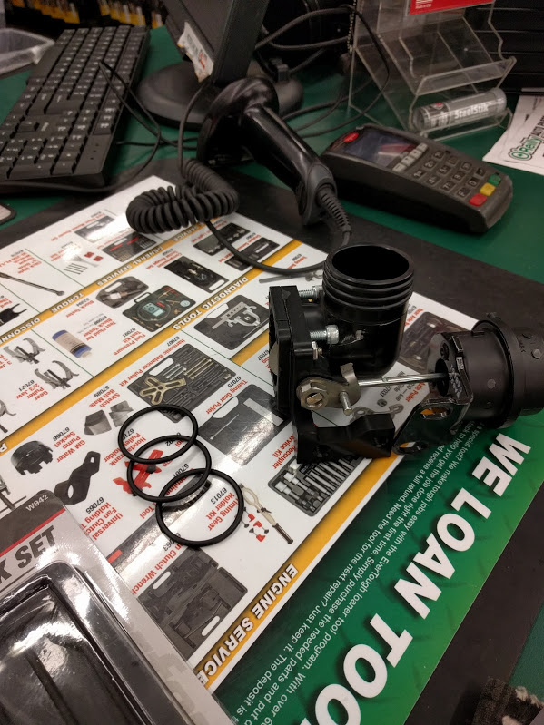

Originally Posted by marineusmc4
I think I'm sold on the whipple
If you end up getting the whipple, double check that they actually put the o-rings on the bypass. If they aren't there, you'll be able to see light through the housing when viewing from the bottom.
If they aren't there you'll get a nasty vacuum leak that is a little tricky to track down.
Attached Thumbnails Which SC and why?-whipple1.jpg   Which SC and why?-whipple2.jpg
