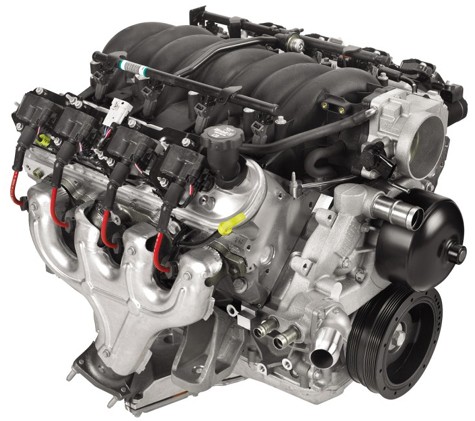

Engine:_______________Injun:
Attached Thumbnails Reduces Ingine power light on?-17801268.jpg   Reduces Ingine power light on?-indian.jpg
LOL! i was thinking the same thing when i saw his thread title, i was like WTF?....
