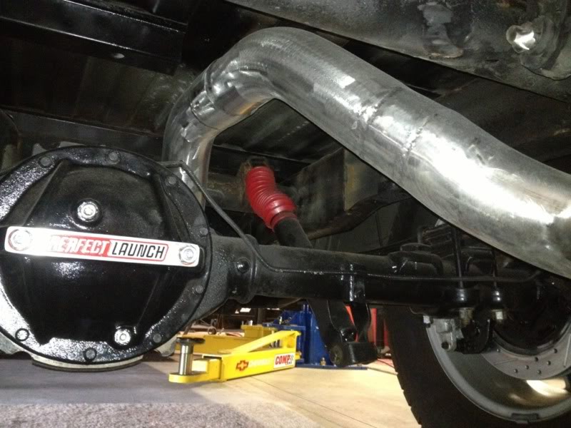

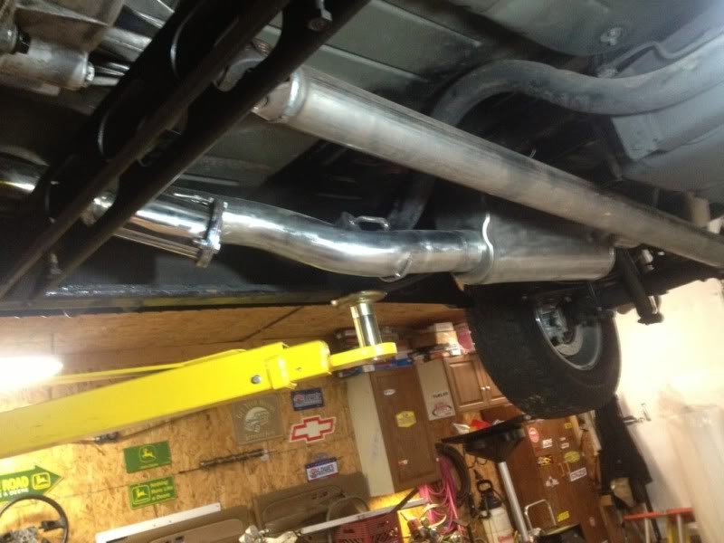

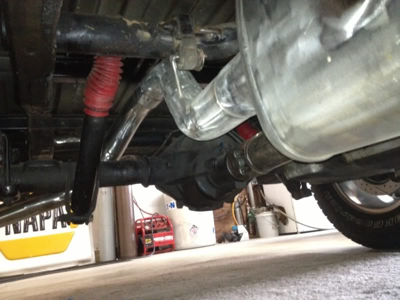

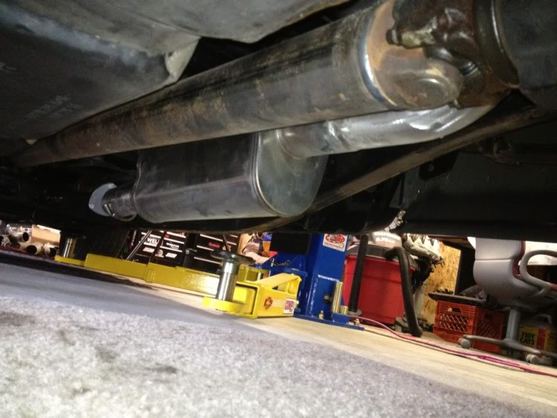

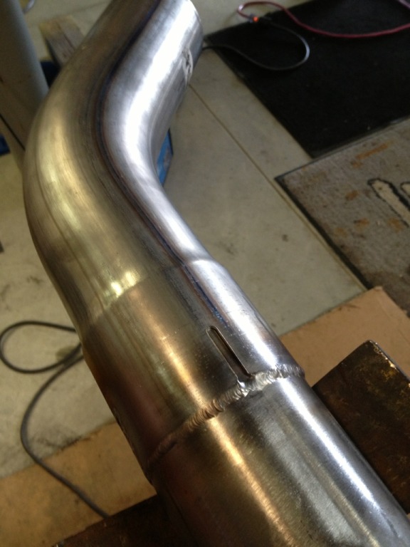

Finally finished my one of my winter projects.
Re-Fabbed my exhaust out of 3.5" stainless steel , I TIG welded most of it , but the thin *** QTP cutout I bought just burned thru so I had to mig it and walk over it with a TIG torch . Still have the 3.5" magnaflow , and am ordering a DMH cutout . Have plenty of room over rear axle now with my drop
