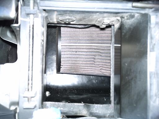

Well, I hate the way the volant air box is sealed with only two holes, so I started a little experiment today. I removed the right side headlight, and there is nothing restricting air flow to the front of the airbox. I decided that I could cut a rectangular piece from the front of the airbox and allow air to flow directly into the airbox. I run at the track without my headlight, so this works great. You can see the pics below. I just used a jigsaw to make the cuts and then I sanded the edges.

Pretty good idea, probably works goods even with the light in there.

The whole point of a ram air is to smooth out the flow of air comming in.

hmmm, I believe the whole point of ram air is to use the dynamic air pressure to increase the mass flow of air through the system. The air flow going into the filter will always be turbulent, that is why the mass air flow sensor has the honeycomb screen. The honeycombs change the flow from turbulent to laminar (smooth). This is same thing used in air tunnels to produce a laminar flow field. So no matter how turbulent the air is, the mass air flow sensor will smooth it out.

Yes, you are correct and I agree with what you say also. Maybe I should not have said "The whole point" . The filter does act as a type of diffuser to also help smooth out flow. But wouldn't cutting a hole in a CAI box defete the pupose? I mean, would a FIPK work under the principle that if the truck is moveing at xMPH the hot air would be pushed away from the engine compartment resulting in cold aire being pushe to the filter? It's hard for me to explain what I'm talking about, so I won't even try. My brain may start hurting. I just take the filter out at the track anyway, and my MAF hasn't had a screen in over 4 years. So in my case, it doesn't matter. After I wrote that, I thought hmmm....might not have been the best choice of words.
