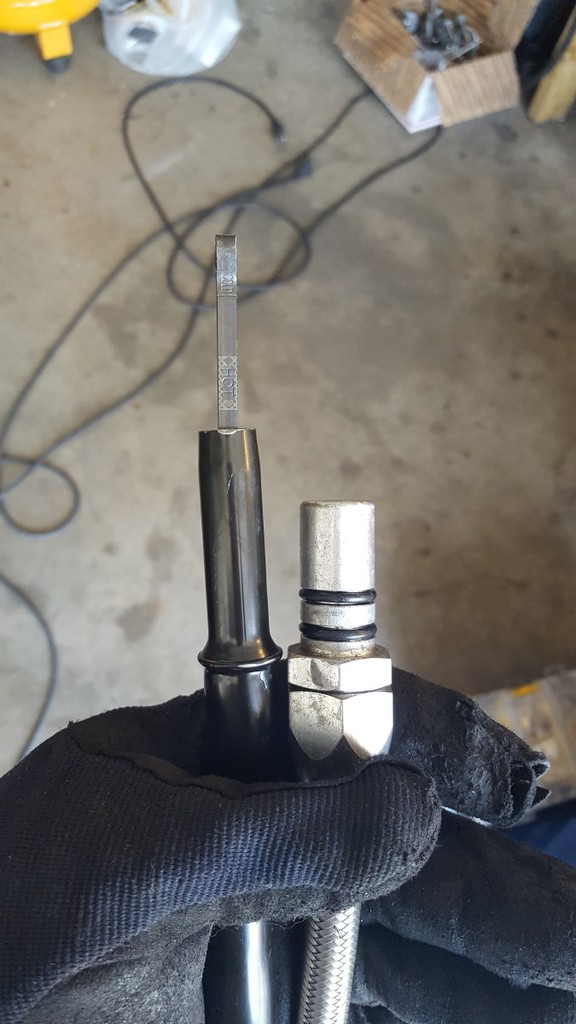

Old Sep 10, 2016 | 02:04 PM
Atomic's Avatar
I have a gauge for that
Posts: 16,282
Likes: 438
Case in point, 4l80e dipsticks, stock on the left, lokar aftermarket one on the right.

Would you happen to have a p/n for the stock one?
