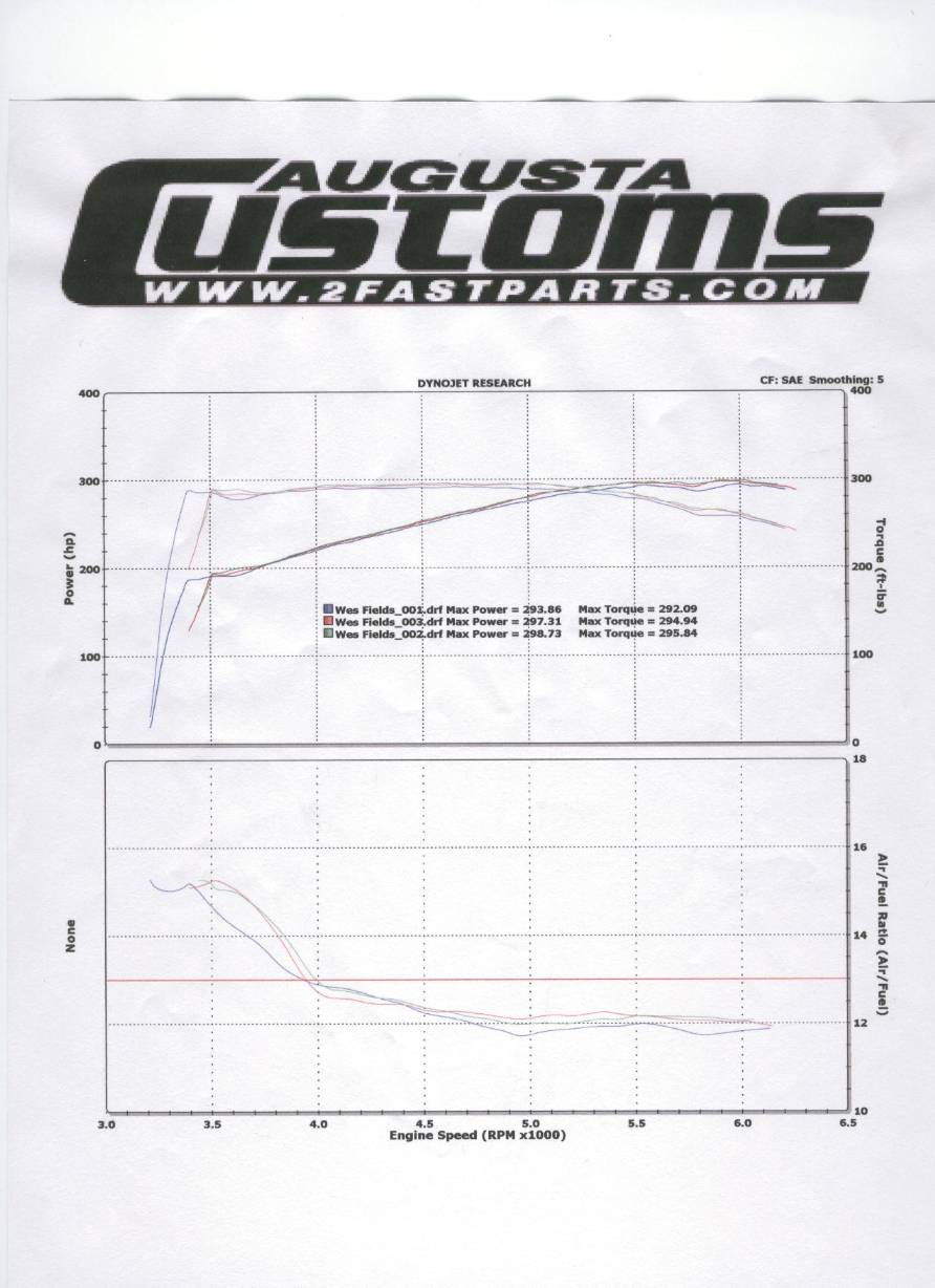

Well, I finally got a chance to put the truck on the dyno today. Here are the mods: 02 silverado 5.3, k&n fipk, Asp underdrive pulley, comp 212/218 .522/.529 114 lsa, Futral motorsports mail order tune, ASM headers, stock Y pipe and single Big magnaflow exhaust, High flow cats, built transmission w/ shiftkit, 4.10 gears. All of these runs were done in Third gear with the stock converter unlocked. Temp was 88 degrees.
Highest out of three runs was 298.73 hp and 295.84 Tq.

Wow, look how flat that torque curve is! Not really a curve at all. Nice.

By the way dtw members linked this site and said 02 Reapers truck was a joke because it dynoed 300rwhp.

hey, I think he's got some good numbers. All of us there are not that way.

I was just wondering what the altiute you had reaper. I know the weather was hot. I bet your numbers might even be higher with altitude correction.
