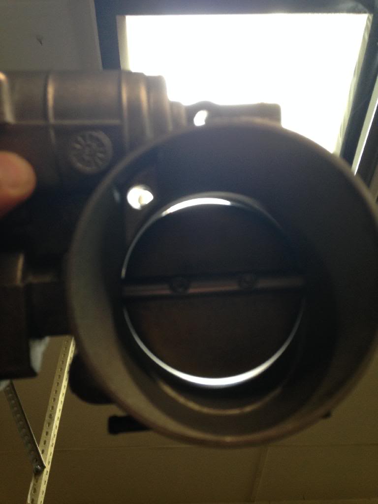

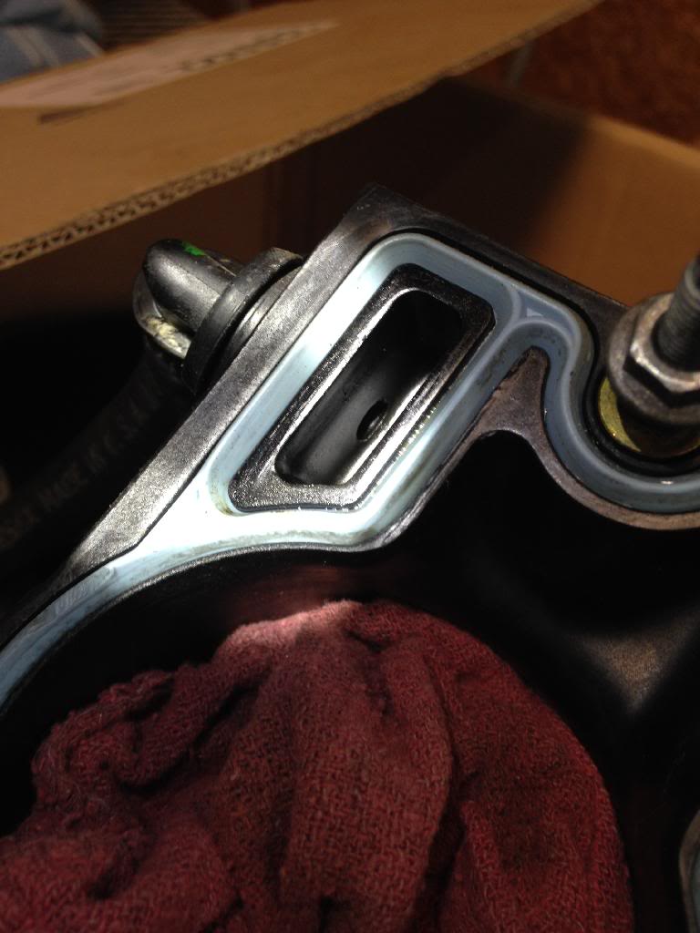

Thats the hole, and he is wrong. Observe.
Wide open hole, no valve or anything. This is your fresh air source for your PCV system, it has its own chamber in the manifold that it going into then into the hose from there to the valve cover. Idle is controlled by the blade. These pics are from my stock intake and TB, I just took them.

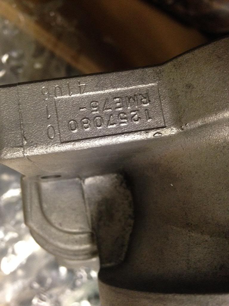

TB part number for good measure.

If it was only a little then it is most likely trapped in that chamber. Removed the TB and clean out that little section.
