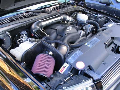

i had a procharger on my 5.3 a while ago. I had the smaller pulley on it and with a custom tune and i made 375 rwhp and 410rwtq. I ran a 13.6 with heavy 20 inch wheels. It is capable of making great power and i drove the thing over 1000 miles a month. i still had stock injectors too. There is a guy on here who made a custom intake to relocate the air filter away from the exhaust.
