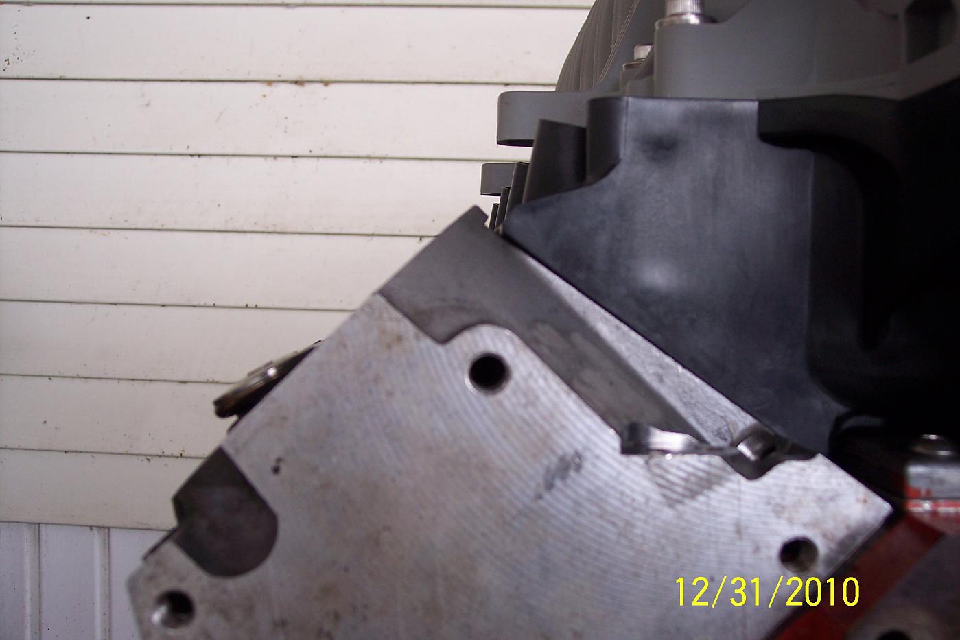

Here are some pics I took. In the first two looking from front of engine, you can see how the manifold is touching the top of the bolts, the middle picture, you can see how it fits,on the fourth picture you can see the lip on the top of the head where the valve cover sits, I had to have that shaved for the manifold to fit under it

Here's an update I countersunk the bolts the thickness of the gasket and the fit is good. I started the engine but so far it won't idle down, it's idling at 2200 rpm. I guess i need to do some tuning.
