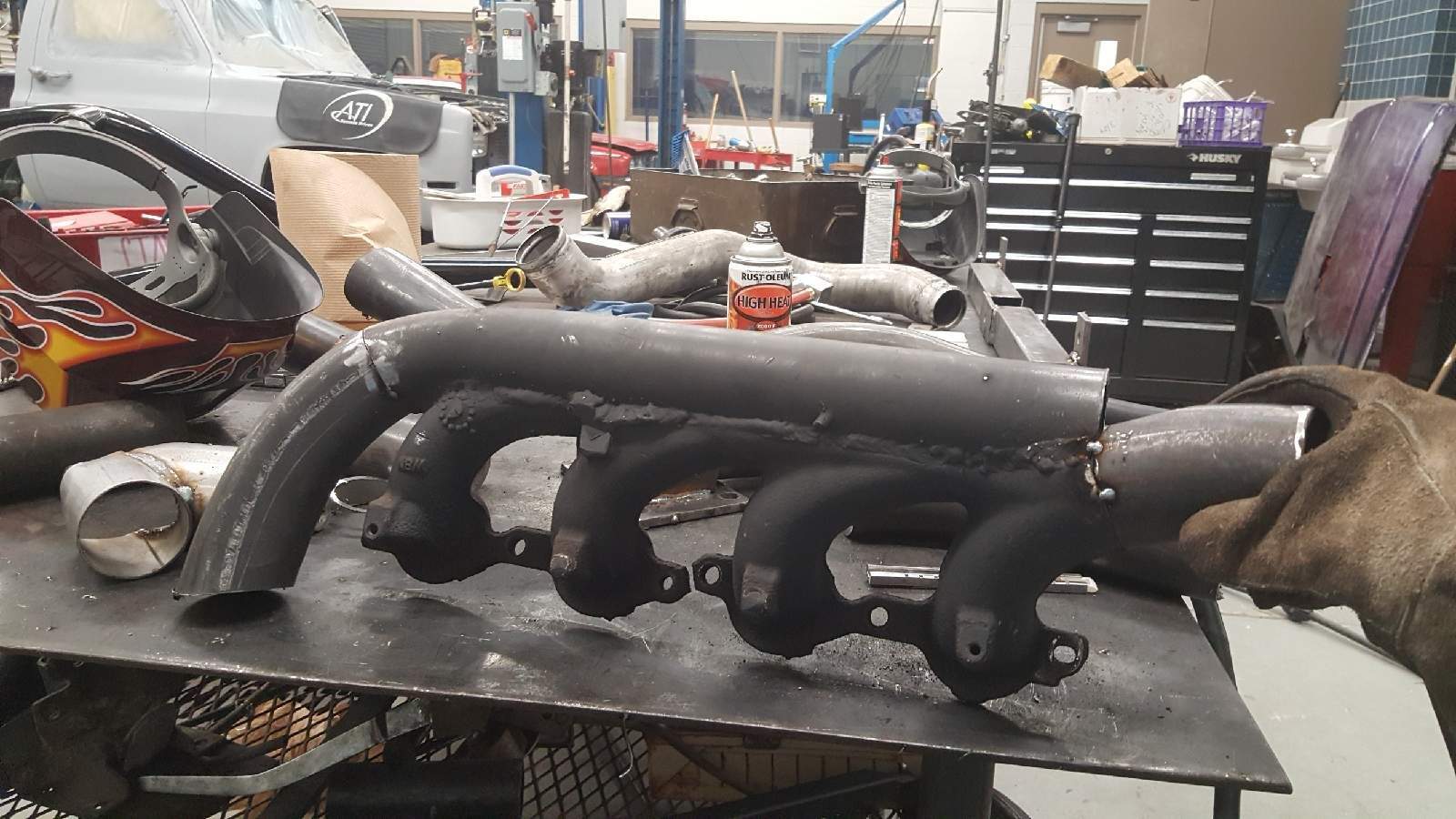

Sounds kinda dumb but has anyone bend the truck manifold made my crossover pipie for my turbo build but my driver side manifold is touching the frame. I wanted to bend it towards the engine maybe like 2 inches and it should fit perfectly
(pic is passenger side)

If you want to bend cast iron I suggest heating it up uniformly to about 2000F first and let it cool very slowly in sand or something.
So basically no, not going to happen.

Bend cast iron 2 inches? That kinds seems like a lot to me....but yes, you'll need to uniformly heat it, don't suggest acetylene jumping from one pipe to the other, but an induction oven. It's going to be quite a chore.
