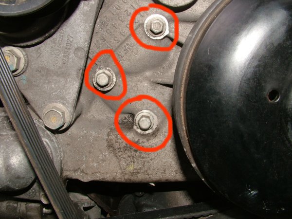

Reference photos. Left and right side bolts for removal of the water pump.
Remember to take your heater hoses off the side.
Clean the surfaces of the block and water pump, then lay your gaskets on the pump. Lay the pump on its side, and slide your bolts through the mounting holes to hold the gasket in place.
Carefully lift up the pump, bolts, and new gasket and place up towards the block. Carefully thread in a few bolts and then slide the pump up towards the block and snug down the bolts by hand.
1st Pass: 15Nm
2nd Pass: 30Nm
C
Attached Thumbnails Pics/Instructions on 99 water pump replacement-leftboltsr.jpg   Pics/Instructions on 99 water pump replacement-rightboltsr.jpg
